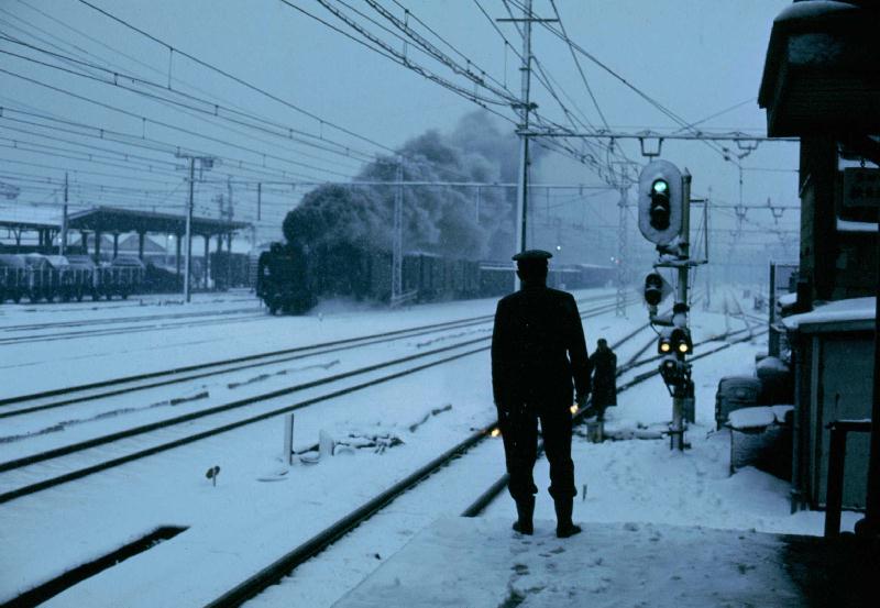

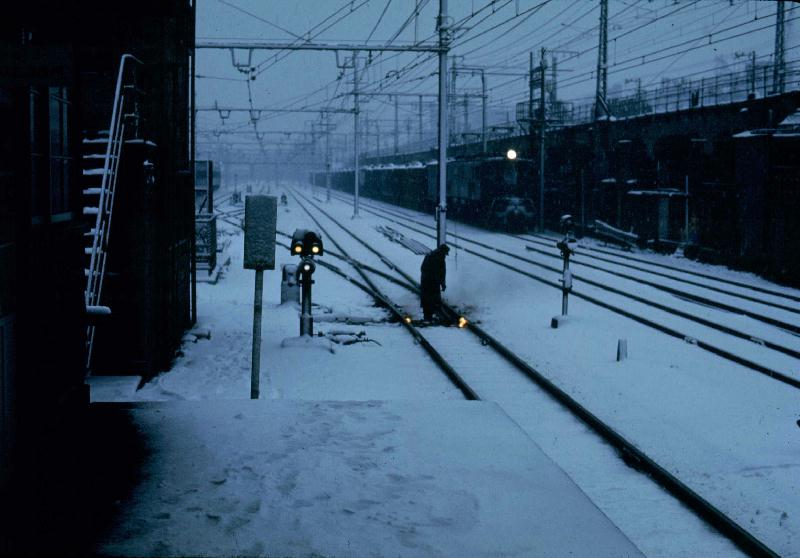

I prefer Japanese Mikados to run on coal like this 1969 view at the Ishakawacho? station. Transportation to Japan courtesy of the US Navy. Notice the fellow next to the signal filling the switch pots. I re-edited and added a view of the pots being filled on the other side of the station platform which somehow ended up being the first photo. Only photos I ever took of active switch pots.
Roger Cole
