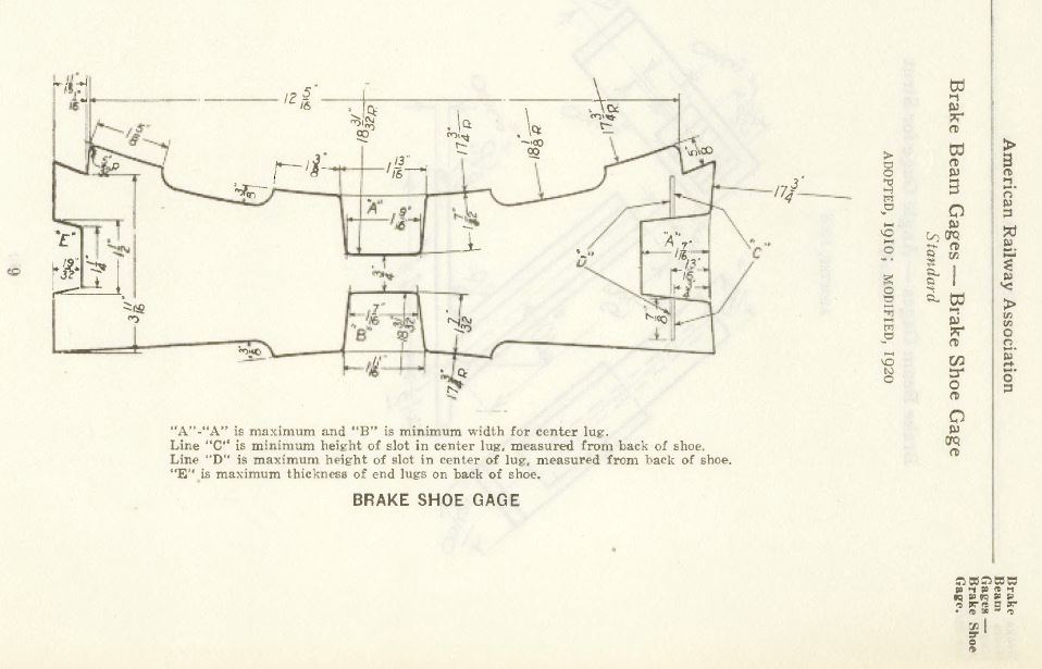

Thanks for looking up that document. In the American Railway Association (mechanical division) Manual of Standard and Recommended Practice (1925 edition), there is a standard for a Brake Shoe Gage as well as a "Procedure for Laying Out Drawing for Brake Head". A newer version may have something useful. Do you have a particular application in mind or do you have a bunch of shoes which you don't know what they fit?
