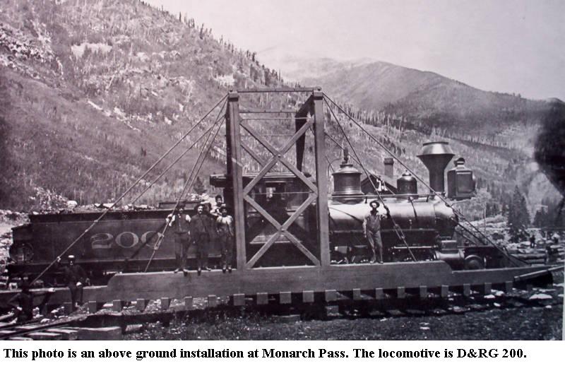

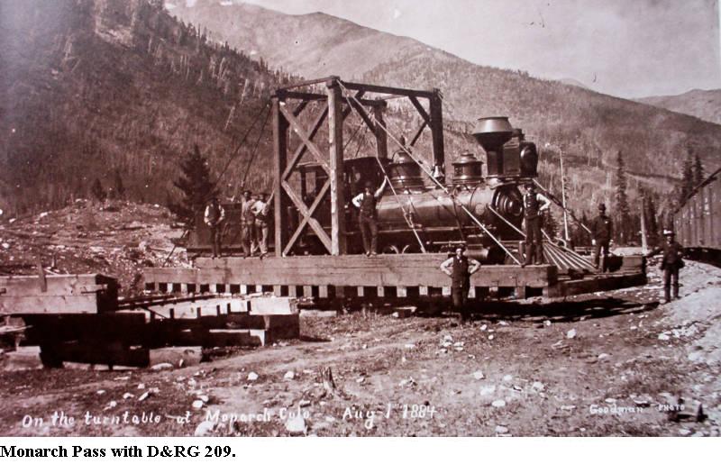

Why worry about little items such as turntable pits and round houses? <GRIN>
FWIW, this installation is at the end of the Monarch Branch and all they needed was to turn locos.
Doug vV
