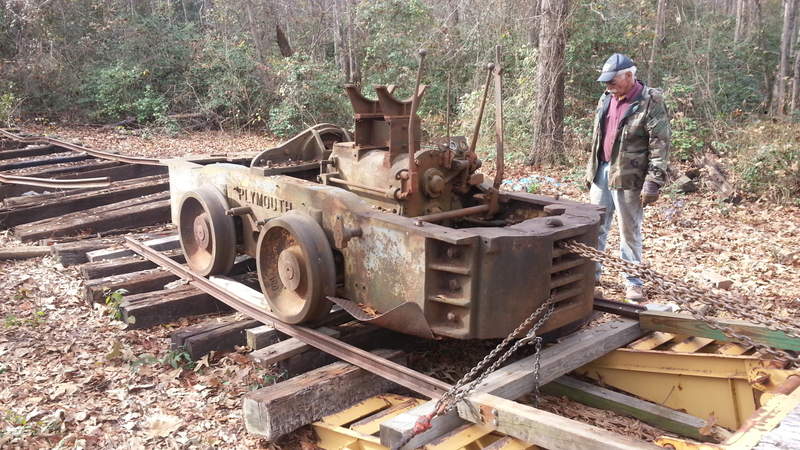

It seems your reengining will be much easier than mine.
I have a 10 ton Plymouth and my issue is the stock gas Buda ran 1200rpm max and 80hp. Hard to find an engine that runs that slow anymore.
I have a lead on a 3-71 Detroit with a PTO takeoff with double clutches. She might run a bit faster than stock but hopefully the clutches will be beefy enough. The stock engine had a torque converter in front of the clutch to dampen the shock.
I watched your video almost as soon as you posted it. Seems like you have a good base and nothing that can't be overcome with a little engineering/fab work.
I hope to get to work on my 'critter' soon.
Adam McDowell

Wow, you seem to be acquiring pieces quicker than I would have thought. Wasn't it this time last year that you acquired an Ore Shunting locomotive from the same museum? I look forward to your updates, but I'm curious if any work has been done on the shunter yet?
 Post subject: Re: Narrow Gauge Brookville at the Railroad Museum of PA
PostPosted: Thu Jun 08, 2017 6:29 pm
Posts: 209
Location: Liberty Hill, SC
Sure Dave!
It is in pieces, but I have about 95% of the parts. It still even has the wheel shields and Model TT headlights.
