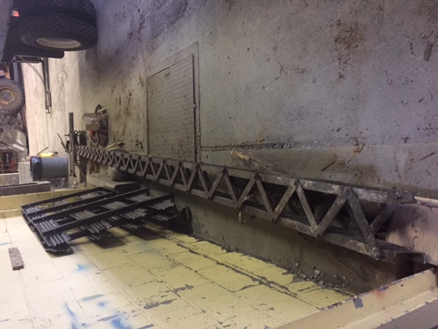

These are not Bates expanded metal poles. The first person I talked with in looking for information on these poles was Nick Kallas at the Illinois Railway Museum, and he suggested the Bates expanded metal poles. However, when I sent him a photo of one, he said it was not a Bates.
This pole is of the type Jim Vaitkunas suggests: Two pieces of channel iron with the small diagonal cross-pieces riveted between the channels. I will post a photo as soon as I figure out how to do that ("Help!").
These poles must have been relatively expensive to produce, as all those rivets were very labor-intensive. This method of girder technology was also in use in buildings before the steel I-beam was developed. The last buildings to be built in the Albany area where I have seen lattice girders used was the Delaware & Hudson's Colonie Shops, built about 1911-1912. So I think lattice girder construction probably ceased just before World War I. I don't know exactly when lattice girders first came into use and when their use actually ended.
Attached is a photo of the trolley pole of present interest. The photo needs to be rotated clockwise 90 degrees for best viewing.
To orient the viewer, the pole is laying down on its side inside the building where it is being stored. The bottom of the pole is closest to the viewer, with the top of the pole in the distance.
The photo should give a pretty good idea of the two pieces of channel iron with the diagonal cross-pieces riveted between them.

Those South Shore poles look like a similar lattice-type technology, however the South Shore poles look like they are four-sided with the diagonal cross pieces on all four sides. They probably would have been constructed from four pieces on angle iron with the lattice attached to each angle.
Our pole is constructed of two pieces of channel iron with the lattice between the free edges of each channel. So there are two lattices on each pole.
