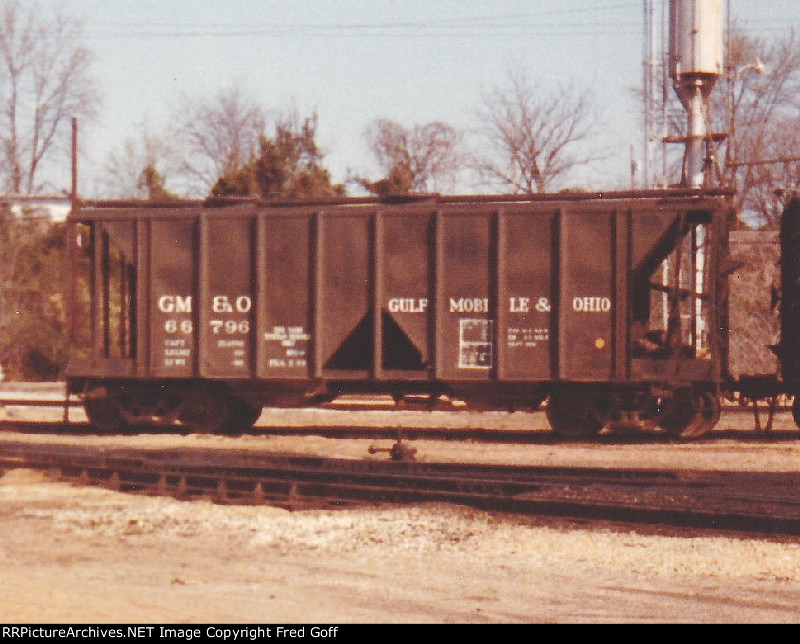

I think the correct number slot is 66xxx, the 80xxx number slot are three bay PS-1 hoppers.

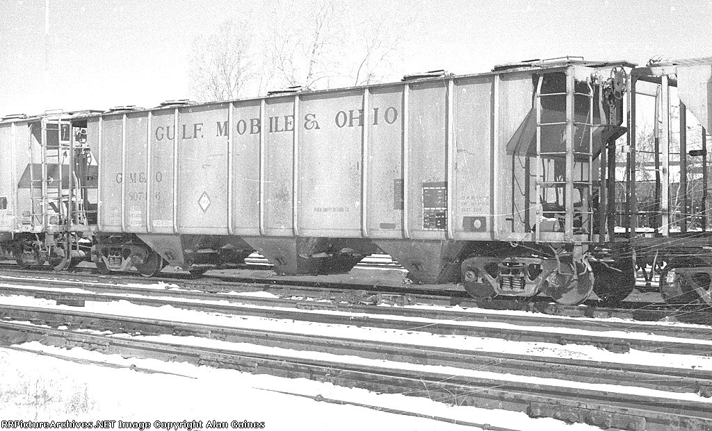

Corrected, here is an 80xxx slot car:

As you can see, this photo shows a two bay covered hopper car numbered 80601. This is from a different series of cars, built by AC&F in 1949 and numbered GM&O 80500-80649. I didn't include that series of cars (and another PS series numbered GM&O 80000-80049) because both of those series of two bay covered hoppers were built in the late 1940's and MRM shows on their printed roster that their car was built in 1953. So where did I get my information? From an internet website (must be true then...right?) entitled "railgoat". Maybe his site is in error, but it seems to have a pretty good roster of GM&O freight cars. Incidentally, that website says that the three bay covered hoppers started with GM&O number 80700 and went up from there. The two bay covered hopper photo you show is for GM&O 66796. And it shows the car not in gray, but in freight car red. Could this have been a renumbering, perhaps when these cars might have been downgraded into company service? I don't know; I can't quite read all of the lettering on the car. And, as you can tell, I am far from an expert on GM&O freight cars!
Well, we seem to have a slight disagreement about the GM&O numbering. Hopefully someone can straighten it out so that the boys at Monticello can get the car painted, lettered and numbered correctly.

Les, you are right, it is rather confusing. The caption for the 66796 I posted says it is a sand car, which would be revenue rather than MOW. It could be that GM&O numbered their cars according to use rather than type. Looking at this list of GM&O hoppers it appears that ACF centerflo's were mixed in with your car and three bay PS-1s in the 80xxx and above series: http://rrpicturearchives.net/rsList.aspx?id=GMO&cid=4
I have yet to find a master list of ICG freight cars and what their past numbers were.

Sand service could mean they were in company service at the time. The P&WV rostered two covered hoppers (#P433 and #P434) retired from regular revenue service that were used strictly for sand loading only.

If you scroll down and check the 66xxx series of GM&O numbers, you'll note that all of these cars seem to be used in company service. Some examples:
#66160 - tank car
#66630 - old coach
#66949 - box car
My thinking then is that the covered hopper pictured (GM&O 66796) is in company sand service, probably transporting sand for locomotives.
Doesn't help with paint and lettering for the Monticello Railway Museum covered hopper, but seems to at least solve the question about numbering.
