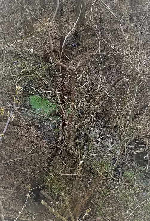

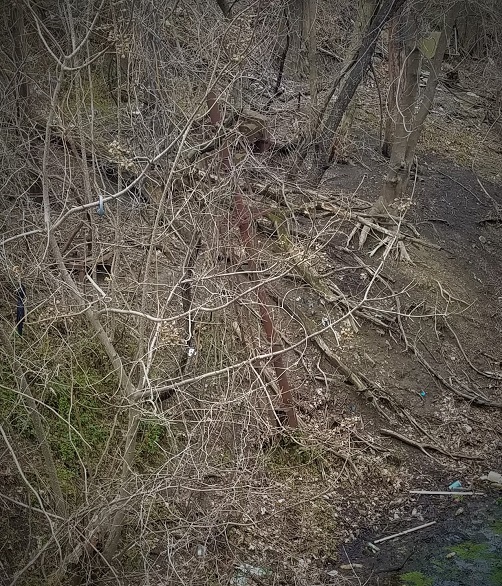

Sorry it took so long to get these photos.

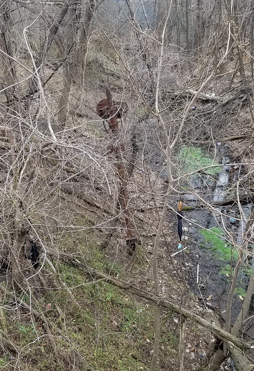

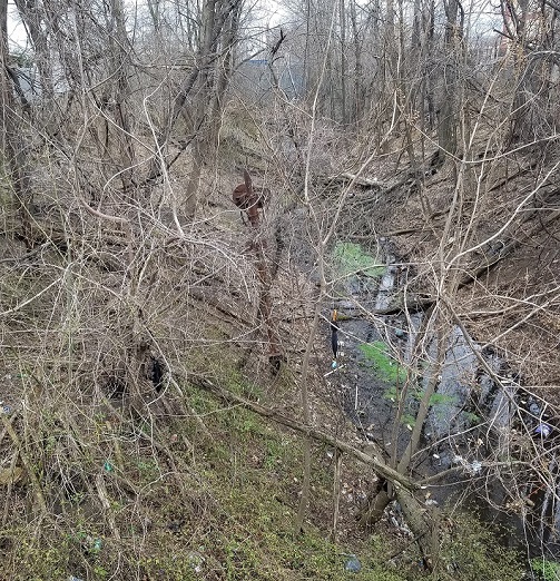

 Post subject: Re: An old Reading Railroad branch signal
PostPosted: Sun Apr 02, 2017 11:55 pm
Posts: 737
Location: Philadelphia Pa

some digging looks like a 2 light Reading horizontal oval head, usually found around control points.
Any nearby railroads for probable connections, crossings, towers?

That is making sense to me, a low level dwarf absolute signal, horizontal 2 light for clearance to the main. Apparently Reading used some horizontal heads, the umbrella in the pic threw me off expecting a bigger signal. Its not a target signal. I would say its a rare breed signal worth the preservation and recovery.

That’s not a dwarf.
The umbrella hanging in the tree is much closer to the camera than the wayside and not a true indication of scale.
Mast diameter is likely 5 1/2 inches. As the mast appears out of plumb, damage to the mast or base is suspected. An open RACO junction box is fastened to the base about 3 feet above grade. These boxes run about 50-75 pounds depending on size and absence of door. If the lid is gone, its cast iron hinges may be broken. Assessment of the head is tough with photos provided. It seems distorted and likely weighs 150-175 pounds. It hangs about 13-15 feet above grade. Wayside heads can’t be unbolted and hand carried down a ladder. The site is overgrown, not conducive to access, and liability issues abound. It looks like an accident waiting to happen. There is a lot more work needs to be done with questionable return.
I collected a beautiful Reading GRS SA wayside few years ago. I had a stable base and mask to work with. Still it took two days with good site access, plenty of swing room, 12-foot scaffolding with 500-pound capacity and outriggers, and plenty of BP blaster. Platform, cage, and ladder removal improves head access. The head can be chained, secured and eventually lowered with come-along attached to top of mast or 4x4 spanning top of scaffolding. Once the mast is clear, the mast can be secure to the scaffolding while mounting bolts are removed from the base. Use of a 1-ton chain block and proper chain location allows slow, controlled lowering of the mast. Outriggers provide stability during work activities. Whatever the case, need to be careful.
Hope this helps,
