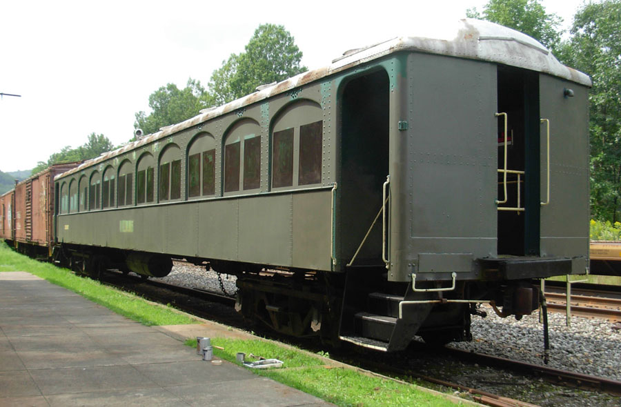

The Erie Railroad once had nearly 400 Stillwell cars of various groups, how many survive today?
I account for 5 arch window coaches from 2100 and 2300 series and maybe 5 cars from other classes.
- Chemung Valley RHS has #2125 acquired from Susquehanna Valley RHS in Binghamton, NY - (see picture). A second car in Binghamton was burned and scrapped in 1995.
- Rochester & Genesee Valley RR Museum has one car 2100/2300 series
- 1 arch window car in Bath, NY at a local business
- 1 arch window car and three or four others on the Whitewater Valley
- 1 as a book store somewhere(?)
- any others?

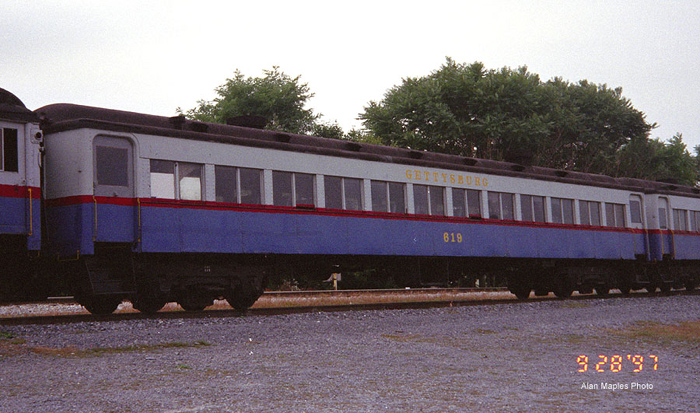

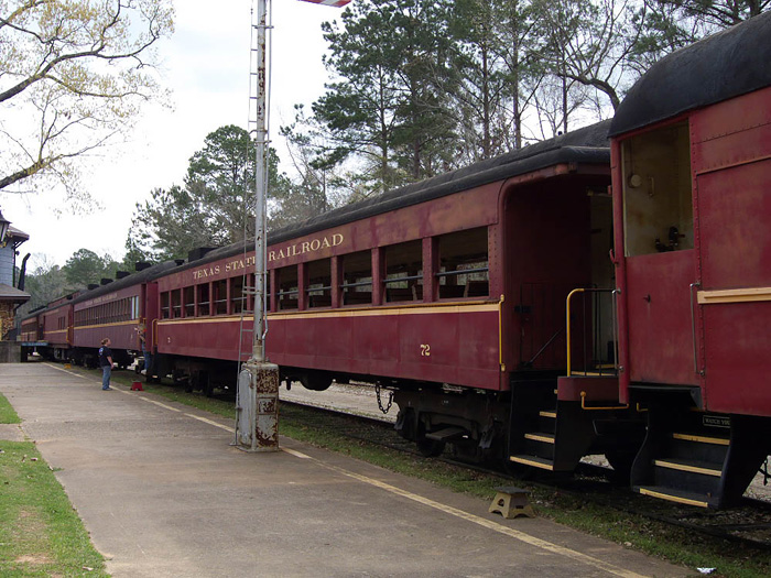

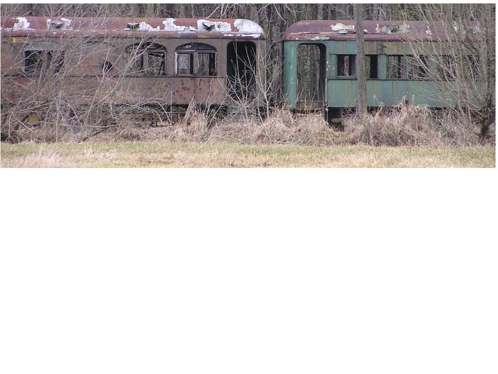

The Williams Grove Steam Engine Association has the remains of an Erie Stillwell that was part of the 1960's era Everett Railroad excursion train.
Texas State Railroad has at least one Stillwell, converted to an open car.
Sloan Cornell had two Stillwells at the Gettysburg Railroad (from the LA&L train set) but I don't know what happened to them after the railroad was sold.

File comment: Gettysburg, PA, March 1997
File comment: Rusk, TX, March, 2009
File comment: Williams Grove, PA, October 2007

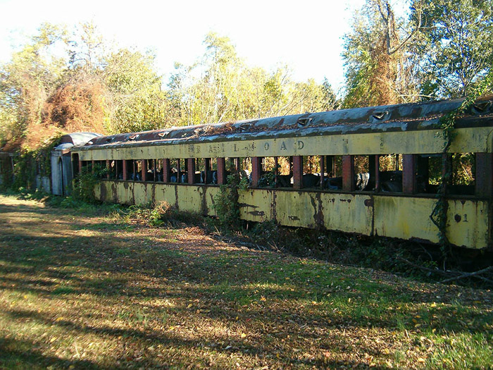

Just to add some information on the Whitewater Valley Stillwell fleet, #2634 has substantial damage to the A end coupler, draft gear, and end vestibule and is stored out of service.
Number 2420 was shipped to us from KRM (and probably arrived to them) with arch bar trucks from a 2300 series car. 2471 has the correct trucks under it so apparently the Erie swapped them around as needed. 2600 is the next coach in line for Pullman green paint followed by 2612 at some point. 2612 needs quite a bit of metalwork before it is repainted.
We are in need of coupler parts and knuckles for these cars if anyone has some! I believe these were designated type BX and were a light style intended for commuter cars.
The WVRR has also purchased the three 2600 series cars that had been stored by Steamtown. These have not yet been moved to Indiana, I don't have the numbers handy, maybe someone out there does?
The Indiana Railway Museum in French Lick has three Erie Stillwell cars in storage. One is a 2400 series (2481 I think), one is an arched roof car showing number 174055 (maybe an MW number?), and a third car that appears to be a 2400 series car. These have been out of use for some time and are stored. I think these were the original cars the group used when they started out in Westport, Indiana. PM me if interested in a few more photos of these.
I'm pretty sure that the Rockford car mentioned above was transferred to the C&WI for commuter work by the Erie, but not sure on the other one.
There was one arched roof car on a tourist train in Petoskey Michigan as recently as 10 years ago, not sure what happened to it, though it apparently came from the Marquette & Huron Mountain auction. I understood that it had a heavily modified interior.
I had contacted the California Western many years ago when I had heard that the cars there were being cut up. I was interested in the couplers but was told that all of them had been scrapped. Perhaps they were only cut down?
At least one of the Stillwells at the Gettysburg Railroad was a 2600 series car. It was listed for sale for some time, did it ever leave Gettysburg? I think Alan's photo is of the car I recall being advertised.

File comment: 2 of 3 Stillwells at IRM French Lick, IN

The cars I noted in an earlier post at the Indiana Railway Museum have been cut up. IRM was very helpful with the WVRR and we were able to acquire quite a number of parts that will improve the fleet we have.
The ex-Everett RR Erie Stillwell at Williams Grove was scrapped several years ago. Also cut up (from the old Everett RR) were an ex-Reading steel coach and the remains of an ex-B&O wood coach. The remains (frame and trucks) of a second ex-Everett exx-B&O wood coach is still at Williams Grove under the ownership of one of the WGHSEA members.
It should be noted that until fairly recently those derelict ex-Everett RR coaches were not owned by the Williams Grove Historical Steam Engine Association, but rather their ownership was with the owner of the Williams Grove Amusement Park & Speedway. He also owned the Everett RR steam locomotive (Baldwin 2-6-2 11) and the Everett's ex-B&0 wood caboose, neither of which were ever owned by the WGHSEA. The locomotive and caboose were returned to Everett, Pa. and are on display.
