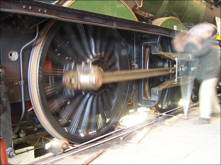

I did find this for inspiration.
Moving the 58 is not a simple task. First realize that I have no help, so there is nobody there to run the backhoe while the other watches the loco. It is just me so I must do things that make it simple on me. Also, that backhoe is either on or off. The shuttle shift is messed up and jerks the machine around, and I don't have time to fix it right now.

Thanks Kelly. Your photo shows what I have had in mind. I already have most of the components that I will need so putting this together won't take me very long.

There are other reasons why I want the rollers aside from just setting the valves.
I can disconnect the drive and turn the rollers with a wrench for the minute adjustments needed for the valve setting.
I was just asking for photos for a specific item. I got them. Thanks. That is all that I needed.

The purpose for a set of rollers is much more associated with continued revolution in the same direction, either for better dynamic balancing including rods-on or for testing. As Kelly noted, if you don't have a shop arrangement that allows moving the engine forward and backward, rollers can be valuable, but I doubt the arrangement he built would be safe either for balancing speeds or as a 'poor man's test plant'.

These rollers will not be weight bearing. Just enough pressure against the tread for friction to spin the driver. I think you all are putting way more thought into this than necessary. If I wasn't down with the flu this week I would have had the device built by the time all of these posts had been written.
All materials, bearings, wheels, shafts etc. I already have. The only thing I needed was a visual confirmation of a design that I Had seen online a while back. I found that and now I'm just waiting for the sickness to be expelled so that I can put it together.
