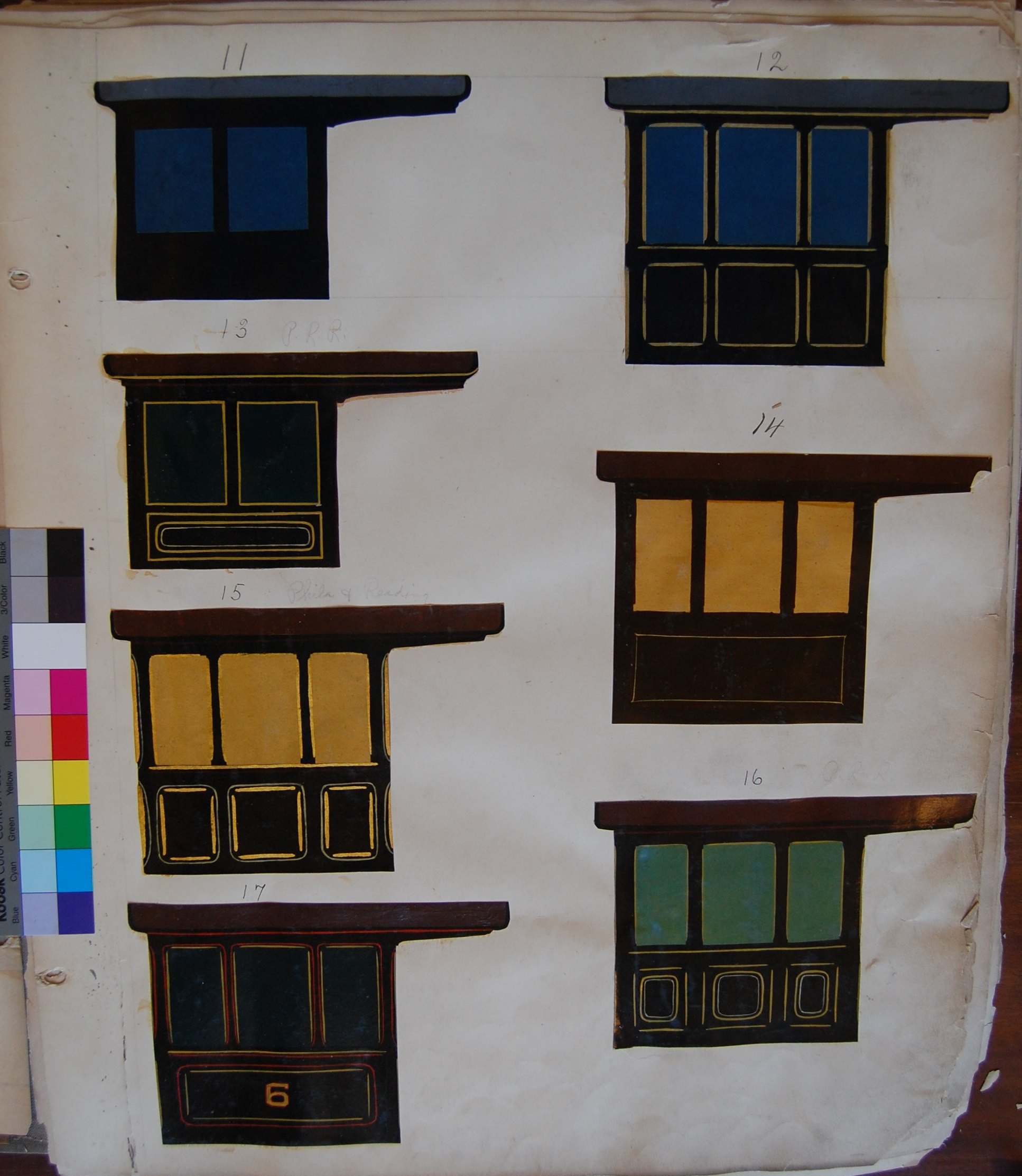

I have a copy of an old Baldwin spec sheet for a small plantation 0-4-4T Forney built in 1894. The finish is shown to be "D106," and the painting style is "214," consisting of "olive green and color."
Can anyone direct me to what this design looked like? Or tell me what "color" might be?
Years ago, Jon Davis colorized a drawing of a similar engine for me using a slightly different painting style, but I have since lost his contact information in the intervening years.
Any help appreciated.

We have some information, including a full index of the painting styles is on line at Pacificng. Start at http://www.pacificng.com/template.php?p ... /index.htm and search from there...
The finish is a description of where to use brass or polished steel or paint on things like the running board nosing. The D series were most commonly but not exclusively used on 6 coupled locomotives. Each D sheet starting with D1 builds on the next, so to make sense of them you have to have all the D sheets, which by chance are missing from the Stanford Library collection…
The painting style is the instructions for striping… in this case cab 12, cylinder 12, Tank on boiler “none” dome 31, driver 16, and tank 35… These refer to drawings of the striping patterns in a hand made book. I have copied the both Baldwin color books (also at Stanford) and with some time can assemble a set of the above… Index available at http://www.pacificng.com/pdf/web/viewer ... -index.pdf
Olive Green and Color means that the locomotive is olive green, with yellow paint in place of gold leaf.
I have included the page with cab 12 below
