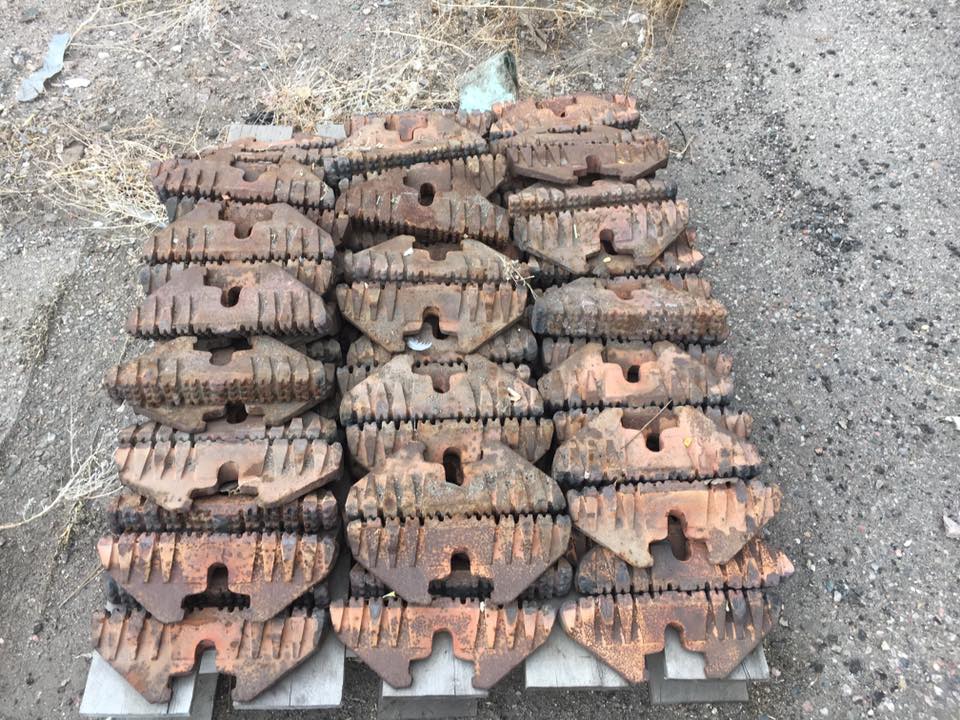

UP 4014 will be oil fired and so they are surplus. Apparently by the 1940s Alco made their grates interchangeable.
17309075_10155118269663781_7523960724472460999_n.jpg [ 150.84 KiB | Viewed 7457 times ]

Like so many items on steam locomotives, these are a manufactured accessory item: Firebar Unit Grates, made by Waugh Engineering. There was a competitor, Hulson, that made an almost identical item (but not interchangeable). UP specified these, and Alco installed them when the locos were built.
If a grate section was damaged or burned off, the small unit could easily be changed without discarding the entire section of grate.
I recall that in the early 1980s, UP sent a pallet of Waugh grate units out of 3985, to the Valley Railroad at Essex, Conn., for VRR #40.

Yes, new grates can be cast. FWRHS has the pattern and almost 800 new "Fingers" are now being cast for 765 spares, a new set for Perre Marquette #1225 and a new set for Western Maryland #1309. They last for years as long as you don't dump fire from the grates, filling the ashpan and burning the grates from below. But it's a simple thing to change one or two on a bar if they break. (Even has been known to be done with a fire in the engine!)

The grates on the Big Boys had 12% air openings for sub-bituminous coal. Is that a big deal, I don't know. I watched a video of a cab ride on the 261, they had to have a second fireman just to constantly trim the back corners of the firebox. Maybe, they could use a different stoker. I don't know, but they may have already fixed the problem by now.
