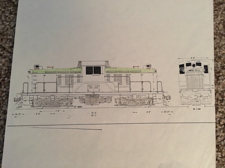

Is there anyone here in this group who could help identify this loco by ton and builder? I have lost the printed info which goes with this drawing.

GE SL144 The spec sheet drawing shows a single stack, but two prime movers are installed. https://www.thedieselshop.us/DataSL144.HTML

I know that the GE SL series is too new for this one .

I think it's a pre-war Whitcomb of some sort, looks like one of the units sold to CB&Q. My "Diesel Spotter's Guide" is in storage now!!

I just took a high-speed flip through three spotter's guides, and came up with absolutely NOTHING that matches, even going to tiny builders like Whitcomb, Davenport, Plymouth, and Atlas.
The separate headlights are indicative of a very early design. The general scale indicates a larger loco, but once again I cannot find an exact match.
What does it say above the radiator--where others have put "PLYMOUTH" or "DAVENPORT"?

I would have said Porter, but it's bigger than anything in their catalog
Looks like it says CUMMINS DIESEL. Which means the radiator was to be supplied by the engine manufacturer. Very common early on.
Could have been a one off, or prototype. Export possibly?
I agree the seperate headlight indicates early on for sure.

My Diesel Spotter's Guide is packed away also, but I seem to recall that CB&Q had three (I think) early centercabs built by either Midwest Engineering, or Midwest Locomotive Works; only three locomotives ever produced by this builder. The angled braces under the cab seem reminiscent of those units.

In the 1967 edition of the DSG (which cost me all of 50p a few years back from the Great Central Railway secondhand bookshop...) it shows this Cummins Engine Company loco in the "Miscellaneous Bulders" section at the back on page "Misc-5"
It lists it as a 90T, 1000hp loco built in 1937 for the Fort Worth & Denver City, powered by two 7x10 Cummins V-12 engines, with GE electrical equipment.

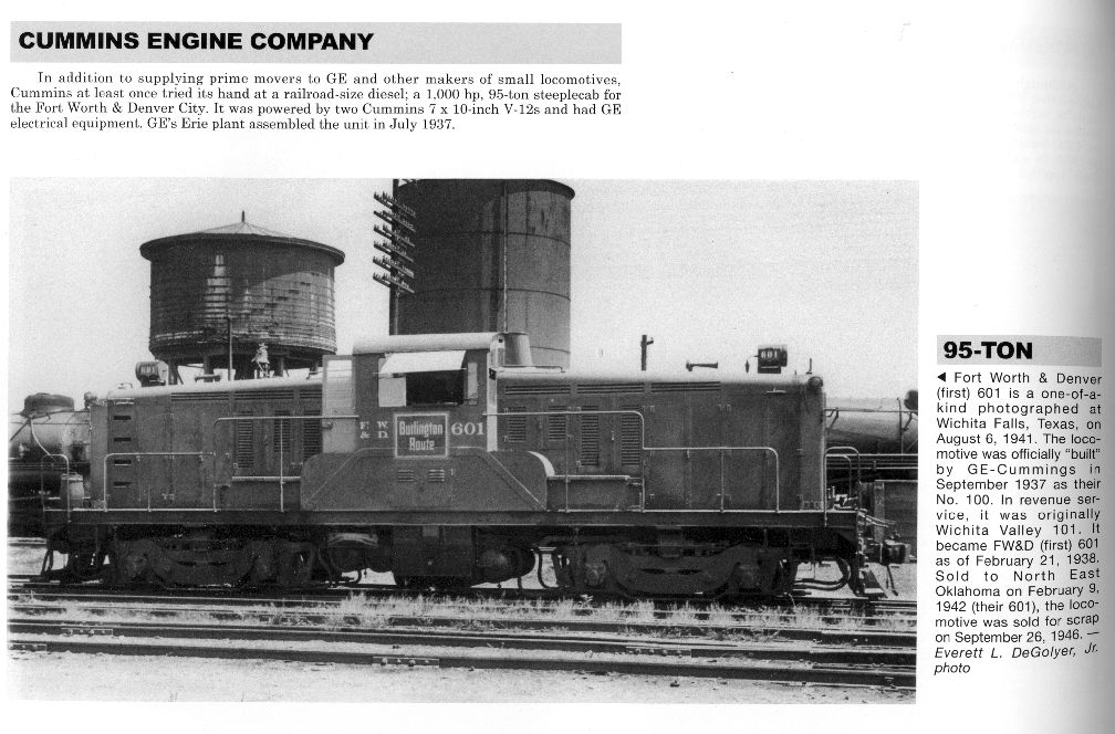

The elevation view matches the illustration of the Cummins Engine Company locomotive in The Diesel's First 50 years by Louis A. Marre, published in 2012. This was a 95-ton unit that reportedly was assembled by GE in 1937.
File comment: From "The Diesel's First 50 Years"

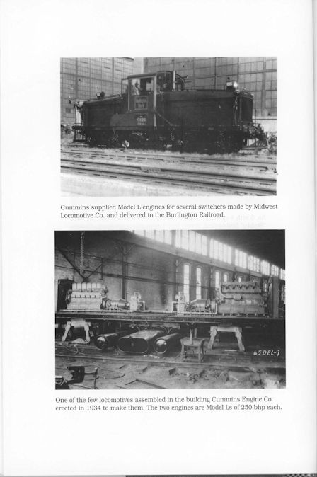

The Midwest Locomotive Works and Cummins Engine Company products are also covered in the big (8.5"x11") horizontal format book The Diesel's First 50 years by Louis A. Marre, published in 2012.
Lyle Cummins in his book, Diesel Odyssey of Clessie Cummins, Carnot Press, 1998, about his father and the early years of Cummins diesel, tells of the project with Midwest. The manager of the Cummins company was much more enthused about the concept of diesel locomotives than Cummins himself was. Lyle Cummins indicates that the Cummins company assembled these locomotives. The company even obtained and relocated a bolt-together building to assemble the locomotives.

It's definitely not a GE SL144. VMT has one of those and it's much uglier than the locomotive in the drawing.

Brian, Thank You , you came through. You had the information I needed. Again Thank You.
