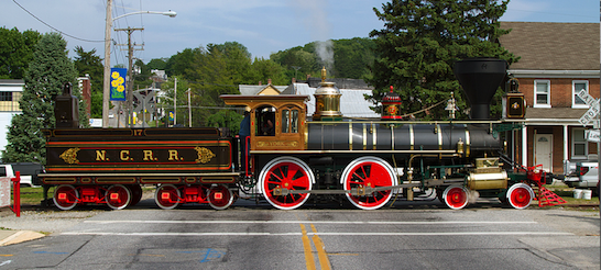

I am seeking an article or anyone who happens to have knowledge of the construction of NCRY 17 YORK , this is for my own personal collection and use! I once resided in CANANDAUGUA, NY and was given the book. I was long aware of the Original NORTHERN CENTRAL Railway due to my Grandfather's Grandfather .
Thank You,
Mr. Starr

She's the newest steam locomotive in America, delivered from the Kloke Locomotive Works in 2013.

If this locomotive is based on the locomotives at Promontory, Utah, as was stated in a prior threads, a mostly complete set of drawings for is available on the Internet. They were commissioned by the National Park Service and are in the public domain. Find them at http://ibls.org/mediawiki/index.php?tit ... ocomotives.
I wouldn't describe these locomotives as replicas. They apparently used a new design and modern (30 years ago) fabrication techniques. Many parts that would have been cast or forged in the prototype are fabrications. The design is probably more closely related to very large live steam locomotive than to a historic replica.
Thank you Mr Morris for providing that link, it's fascinating stuff. Unfortunately the files do not seem to include the boiler drawings which is what I was interested in seeing. The drawings did show the engines equipped with Laidlaw - Drew style oil burners (centrally located swirl type burners), anyone know if the engines are still so equipped?
O'Connor contracted the NPS locomotive boiler construction to Mr. Dixon at Dixon Boiler Works.
Pat Hosford
Both engines were converted years ago; one burns wood and the other burns coal.

Both Kloke locomotives have new 2" Von Boden oil burners. They are a thing of beauty.

I would think the documentation on the boiler was provided to the NPS and would have been retained by them as these are operating steam locomotives. Since NPS is "us," the drawings may be available through a records request.
