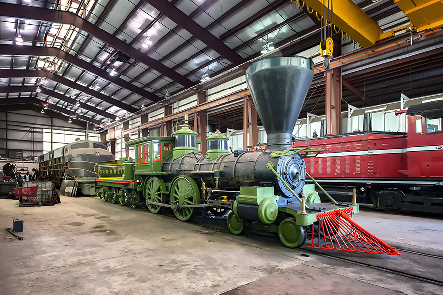

The Baltimore & Ohio Railroad's 4-4-0 "William Mason".
Back in October of 2016, I took the opportunity to take one of the few tours the B&O
Railroad Museum offers each year. One of the locomotives, among others, was the
Museum's prized Mason Machine Works 1856 4-4-0's, the William Mason.
I did ask a few questions, though the answers elude my recall.
Apparently, the locomotive - an original, not a replica, is undergoing her mandatory 1472
service inspection /overhaul.
She's worn a number of paint schemes over the years - a quick trip to RP.net (search
"William Mason"), or.... click this link:
http://www.railpictures.net/showphotos.php?train_id=William%20Mason
You'll note she wore a red, black and what appears a light blue /white, later the dark
green we've come to know, but prior, to her last look, the gold trim was more elaborate.
And now... see below. If I recall correctly, I was told the livery you are seeing here is the
livery based on paint hidden under previous layers and deemed accurate at least at one
point in her history. Not very appealing - with the wheels now completely green and the
red trim on the cab, though, not sure what color the sheet metal wrap will be, and of
course, she's not finished, either.
I recall hearing some issues regarding her return to service as well - can't recall the
details. In the past, while in operation she could not haul a consist of any sort due to a
lack of proper braking application.
So - what light can we shed on her today?
What livery IS accurate? Or, what liveries were accurate and when?
And, is anyone in the loop regarding her return to operation? Is there an issue that
would preclude anything other than a cosmetic restoration - an issue that would require
unanticipated funds /major repair / or meeting new regulations?
/Mitch
And, why yes - that is the B&O EA #51 in the background undergoing a full cosmetic
restoration! I'll post a separate thread later...

For an engine that's 161 years old, I'm sure a lot of different schemes can be called accurate, depending on the era that interests you. For certain, the engine did not carry the name William Mason until after her normal service life. She was number 25.

The paint being applied in the picture is based on the bottom layer of paint found under scrapings. The wheels now include red centers with a star pattern trailing into each spoke. The work is purely cosmetic as the 1472 revealed that 25 will need a new crownsheet before a return to operation. Those of us who work with steam at the B&O hope to see a return to operation at some point, but when it happens I wouldn't hold my breath to see a train behind it. Society Days at the museum this weekend will include the availability of restoration shop tours where progress to the #25 can be seen.
I'm curious as to how they determined the exact shade? I'm sure you've seen photos of old red pickup trucks sitting in a field, all faded to drab dull burgundy.
While it's obvious it was green, how do you know which green? What if it faded before they added the next layer, or if, over time, the paint chemistry has changed, and thus the color has shifted?

....Or they just thought "wow, this is an ugly paint scheme, let's tone it down a bit, shalst we?"

With the aged color matching, not sure if you have seen how paint chips are processed for color matching, but the simplified explanation is the ship is suspended in a clear epoxy, and the technician sands the chip at a slight angle so that all layers survive, but wide enough bands are exposed to get a color scan. So in the stack of color layers you will be able to tell where the environmentally damaged paint is and where the unaffected zones are. Alternately if you have access to a high magnification microscope than looking at the cross section of the paint layers is enough to tell the original colors.
With the question of the boiler wrap, most likely based on the color scheme they are replicating, my best guess would be a planished wrap (i.e. Russian or American Iron as it was called), or a slightly blued, dirty silver paint (to replicate how RI/AI looked under a blue sky, without the maintenance of bare iron sheet). Most likely she would also receive the brass bands to cover the joints between the sheets which were available in 40 inch widths IIRC.
Looks like she was a smart looking locomotive in her era.
