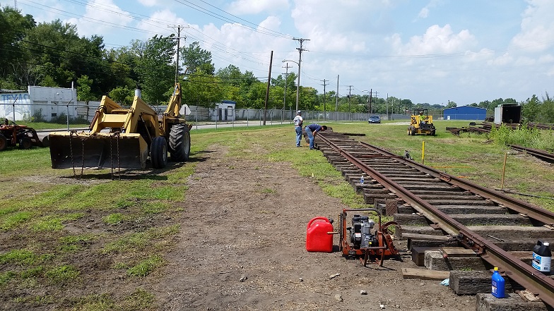

Tomorrow will be the first track laying session since 2007. To supplement the skid steer I brought my backhoe over from YSH, and hopefully we can get a couple hundred feet of track down and at least tacked together, since the Davenport isn't ready to make air for the spiker yet.

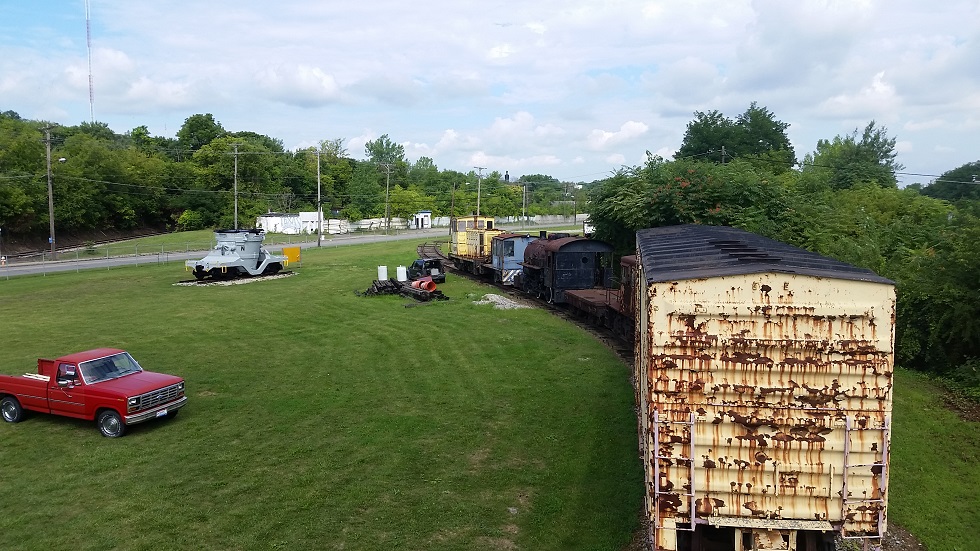

Meanwhile over at the Struthers site we will get started preparing the equipment that can go by rail to be accepted by the short line, and start trucking the pieces that would never be acceptable to go on its own wheels. All of the equipment is on a siding that at one time had ties but no longer does. Just two strings of 85 lb. rail in dirt is pretty much what we have to work with. So the Davenport will at some point be trucked to this location and used to drag each piece out one at a time and placed on a much better track. Those two hot metal cars are the furthest down the siding and will be the hardest to get out.

File comment: The lineup of equipment at Castlo Industrial Park in Struthers.

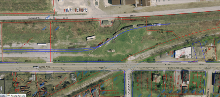

File comment: Initial track plan, which includes realigning the first curve.

Saturday was a good day for the MVRHA as this was the first new trackage laid at the museum site in several years. About 100 feet of track that was originally laid without tie plates was rebuilt with tie plates, several rotted ties replaced and a short stick of rail replaced with a longer stick so that the joints would be staggered instead of across from each other. Three full lengths of rail were also added to extend the track. We would have done more but for the fact that the air supply from the Davenport is not yet available, relegating us all to hand spiking.
The track is being laid in a straight line but will be pushed over into a curve with any skewed ties straightened up. Then about 300 feet of straight track to put down.
File comment: MVRHA president Joe Vasko, Phil Raynes and Steve Berish hard at work. VP Mike McCleery and Secretary Carl Jacobson are out of the photo, with me taking the picture.

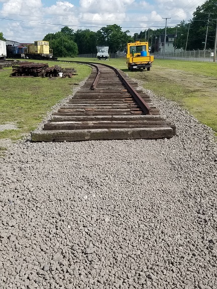

This past weekend our volunteer track crew added another four lengths of rail to Track 1. We are almost to the point where we can start moving the string of equipment northward over the new trackage.

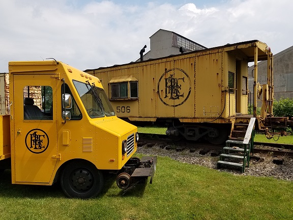

The MVRHA has three pieces in the collection from the P&LE, two cabooses and a boxcar. Spongebob Squaretruck was recently changed from Conrail to P&LE and it looks rather striking next to the 506.
