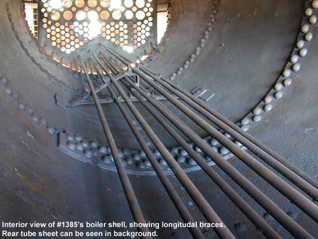

I had this issue solved when I sent a proposal for a new welded boiler to MC way back in Dec. of 2000. Apparently that got document was lost.

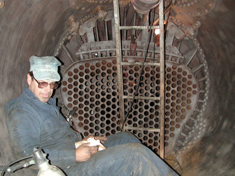

Picture of Skip in #2's boiler on the day I was there...

That seems odd. Why are there no tubes at the bottom of the barrel?
Also, why not brace the tube sheets with angled braces attached to the boiler shell in the adjacent course?

Yeah, not intuitively obvious at all. You'd think that bracing the bottom center with more firetubes would be a no brainer. Nice riveted belly patch.......

It's hard to see how adding larger superheater flues to the upper portions of the tube sheets would have had any effect on the stresses in the lower portions of the sheet, or why adding stay rods versus more fire tubes was thought to be necessary.
Any more info Matt?
