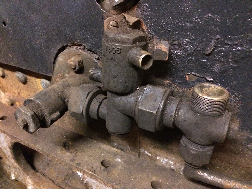

I dont know if this helps, but this is the arrangement that currently exists. Perhaps the casting number on the regulating valve is a good giveaway? I cannot say what is supposed to connect to the three small threaded connections radiating from the vertical cylinder body. Something to a regulating valve? The large threaded connection is the feed up to the flash tank on top of the cab. The pipe leading away from the valve is to a valve outside the cab for drainage purposes. There is no secondary connection to the boiler Overmod mentions unless it is supposed to come from one of the smaller thread connections.
edit:
The lower of three threaded connections could be a connection for a vent?
The upper two could be connection to steam from the locomotive, with one being used and the other as a second connection point option?

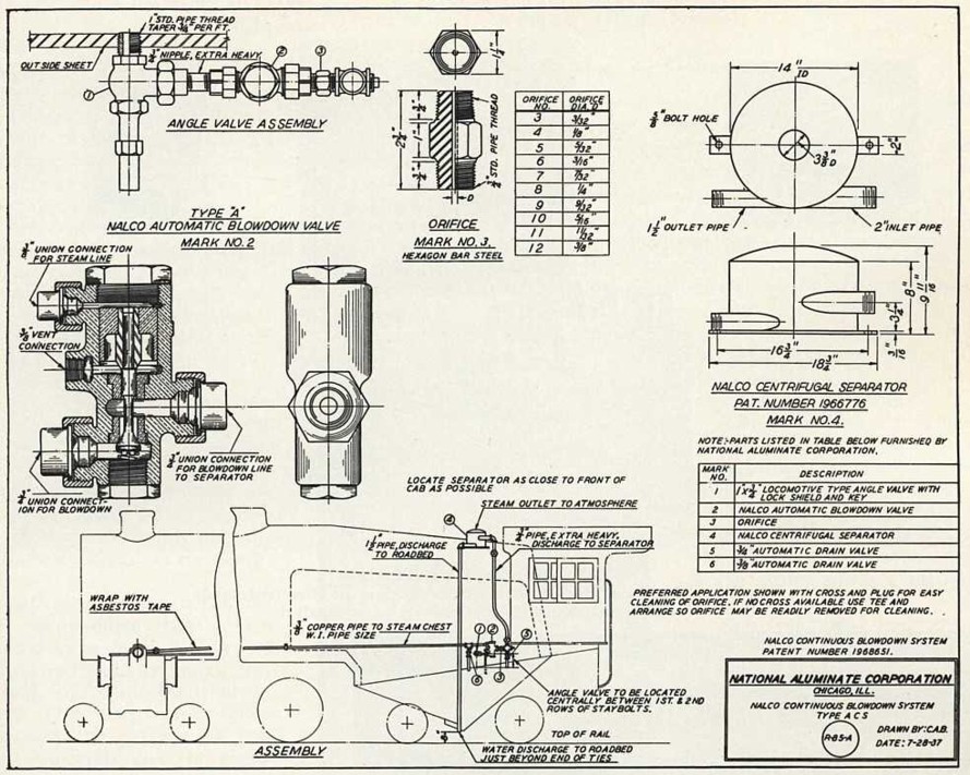

I have for you the following:
-A NALCO Diagram showing the mudring installation of this system
-Details photos of the boiler top installation on CNR 6167
-Photos of the steam seperator and related piping
-The instruction sign installed in the cab of engines so equipped with a NALCO Continuous Blowdown.

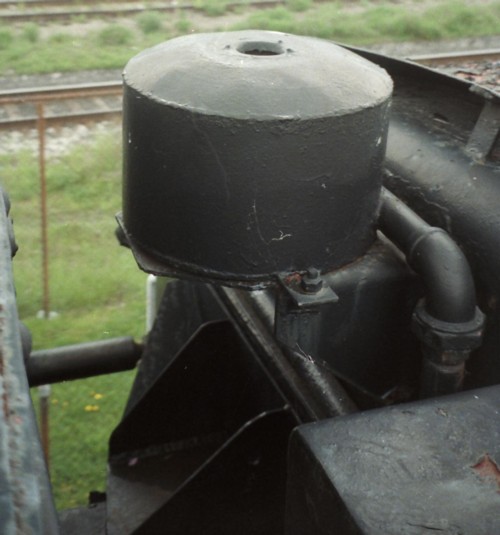

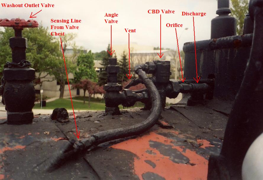

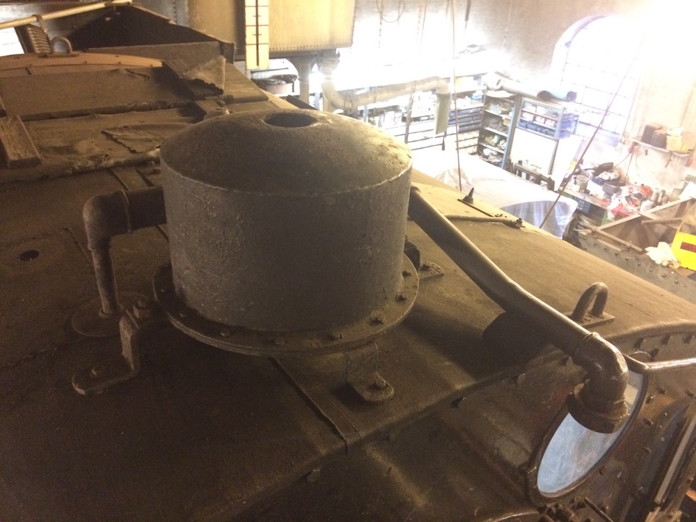

Details on the installation on CNR 6167.
If memory serves me correctly, I believe the vent pipe just connects into the discharge line.
 Post subject: Re: Nalco Continuous Blow Down Drawings
PostPosted: Tue Feb 28, 2017 8:29 pm
Posts: 1119
Location: Warszawa, Polska

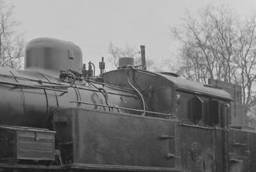

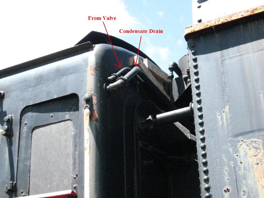

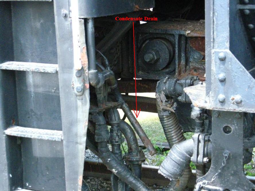

Details of the steam separator piping. The discharge line runs under the boiler jacket to the cab, where it runs through the ceiling to the back corner of the cab where it exits out to the separator, and the condensate drain then returns to the cab and runs down the back corner of the cab and drains at track level.

And for kicks, here's the patent!
EDIT: Found the patent for the steam separator as well.
QUESTION: While the patent numbers were taken from the Nalco drawing, the Patent for the CBD system is credited to a Mr. Verl E. McCoy of Wilson Engineering, while the separator is credited to a Mr. Lyndon F. Wilson.
I'm told that Wilson Engineering did in fact produce a feed water heater system (that was at least used on one CNR 2-8-0, #2758), does anyone know if and what the relationship of Wilson Engineering to Nalco was, or perhaps it was as simple as McCoy and Wilson defected to NALCO etc.
