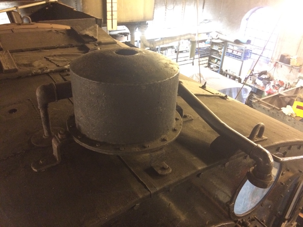

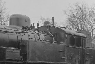

In continuation of the same locomotive (see reflex water gauge thread), it is also fitted with a continuous blow down system. I believe it to be a version from Barco (Nalco) as the Swedes have bought and adopted many other American appliances on their locomotives.
The system has worked before, but something never functioned quite right and now it apparently doesnt work at all. Being that we're doing major work after eight years of storage, I'd like to give it a good look through and see if I cant make it work before the others proceed to blank the flange off and remove the system. The surviving sister locomotive in Sweden had the system removed upon entry into preservation, so the group unfortunately cant help us.
What I am interested in are detailed drawings of the valve unit that actually admits the water from the low point on the boiler up till the "pot" so to speak.
Any help is greatly appreciated!

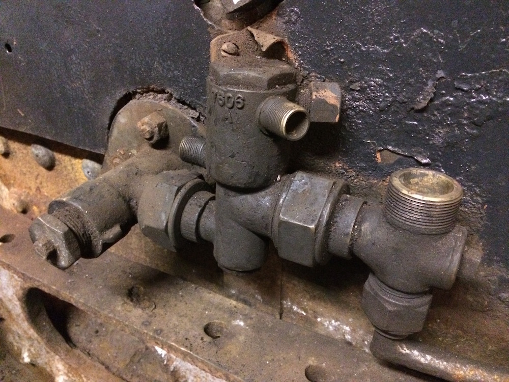

I dont know if this helps, but this is the arrangement that currently exists. Perhaps the casting number on the regulating valve is a good giveaway? I cannot say what is supposed to connect to the three small threaded connections radiating from the vertical cylinder body. Something to a regulating valve? The large threaded connection is the feed up to the flash tank on top of the cab. The pipe leading away from the valve is to a valve outside the cab for drainage purposes. There is no secondary connection to the boiler Overmod mentions unless it is supposed to come from one of the smaller thread connections.
edit:
The lower of three threaded connections could be a connection for a vent?
The upper two could be connection to steam from the locomotive, with one being used and the other as a second connection point option?

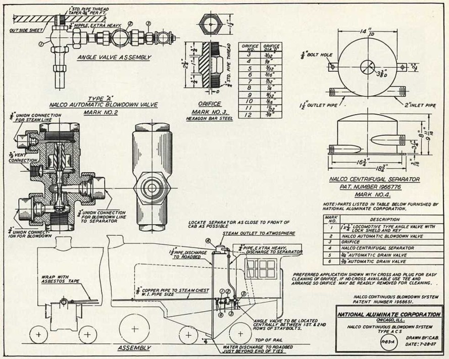

There seems to have been two configurations of it, both which which seems to have utilized the same parts. The earlier (circa earl mid 1940s) usage seems to have been the application of this device at the mudring, while virtually all installations of this device were on top of the boiler, where it just drew water from the top (or thereabouts)of the water line. I get the feeling that the boiler top installation may have superseded the mudring installation (at least on the CNR)
The operation was pretty straight forward as in both cases it is activated by a sensing line that is connected to one of the steam pipes to the cylinders so that it only activates when the engine is moving.
I think the goal of the top mounted installation was more along the lines of reducing the TDS level of the water. Note that even with this device installed, engineers were still required to open the manual blowoff cocks to reduce sludge.
I have for you the following:
-A NALCO Diagram showing the mudring installation of this system
-Details photos of the boiler top installation on CNR 6167
-Photos of the steam seperator and related piping
-The instruction sign installed in the cab of engines so equipped with a NALCO Continuous Blowdown.

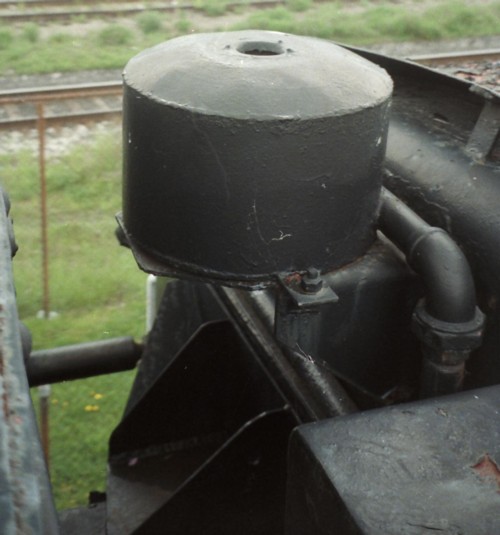

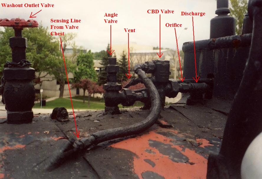

Details on the installation on CNR 6167.
If memory serves me correctly, I believe the vent pipe just connects into the discharge line.

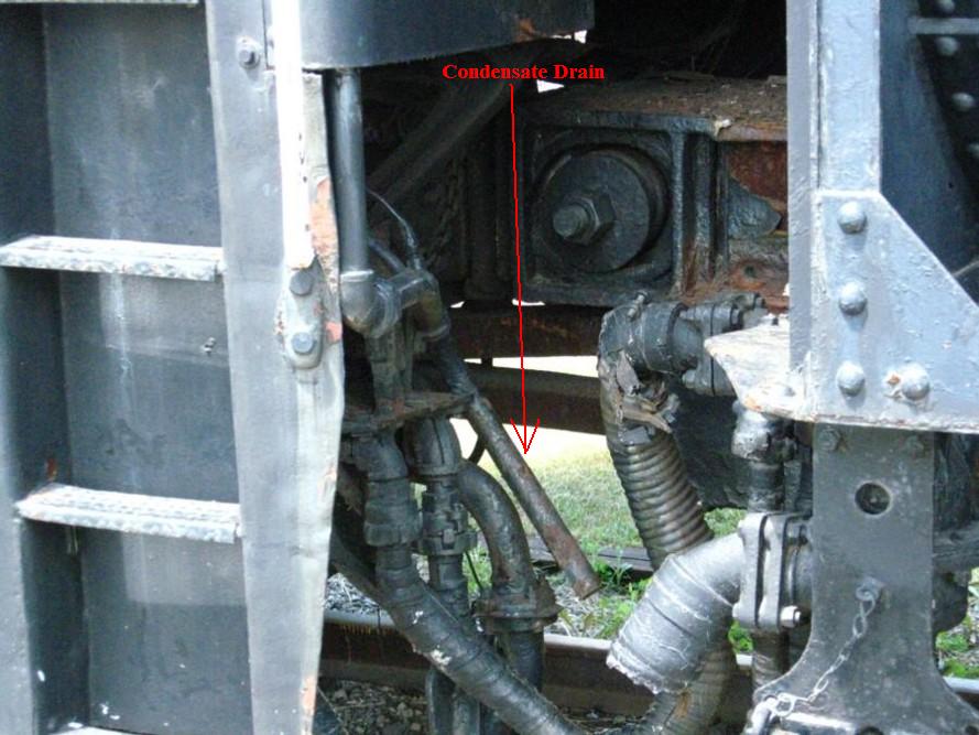

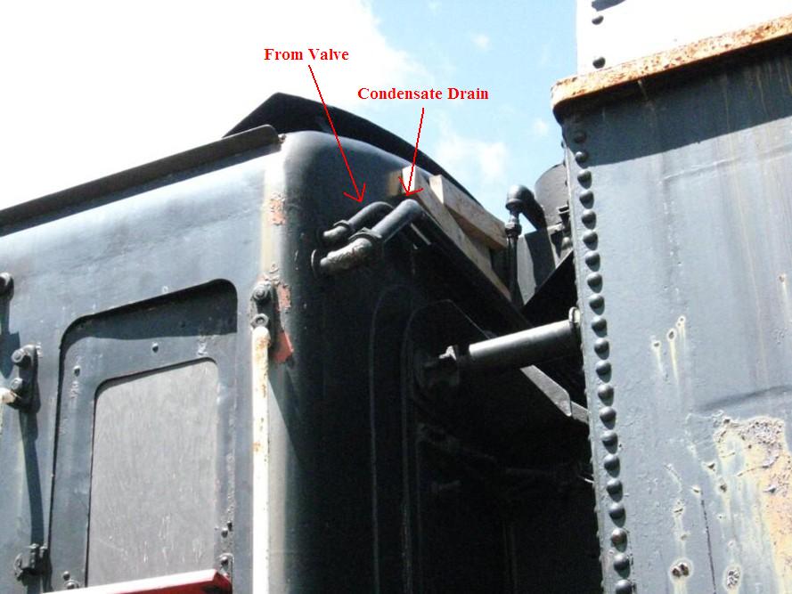

Details of the steam separator piping. The discharge line runs under the boiler jacket to the cab, where it runs through the ceiling to the back corner of the cab where it exits out to the separator, and the condensate drain then returns to the cab and runs down the back corner of the cab and drains at track level.
