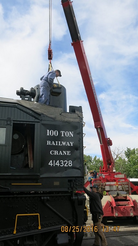

Here's another one for the list. This is our 1920 Bucyrus 100 Ton steam railway crane that we have been working on and will be returning to operation this spring. We are fortunate to have the complete work train auxiliary units, consisting of the flatdeck idler car, the tender, tool car and caboose.

Here is what I have on that one:
Calgary-Heritage Park
Bucyrus C/N 181 100 tons Wrecker Steam 04-12
Canadian Pacific #400167>414328
It is preserved, not in service. There is a much longer list of preserved wreckers than of those still in service.

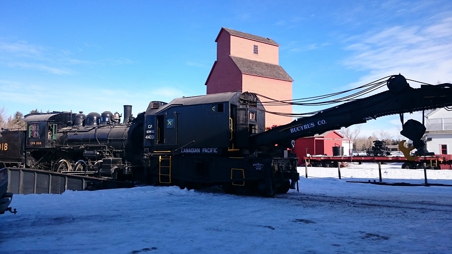

Yes it will be operational this spring. We have worked on it over the winters for the past 10 yrs. and have completely rebuilt the crane, including a new house, welded boiler, steam piping, bunkers, steam dyno , complete rewiring and historically correct lettering. When it is unveiled this summer it will be the only operational steam railway crane in Canada.

If yours will be the only operating steam crane in Canada what happend to this one?
