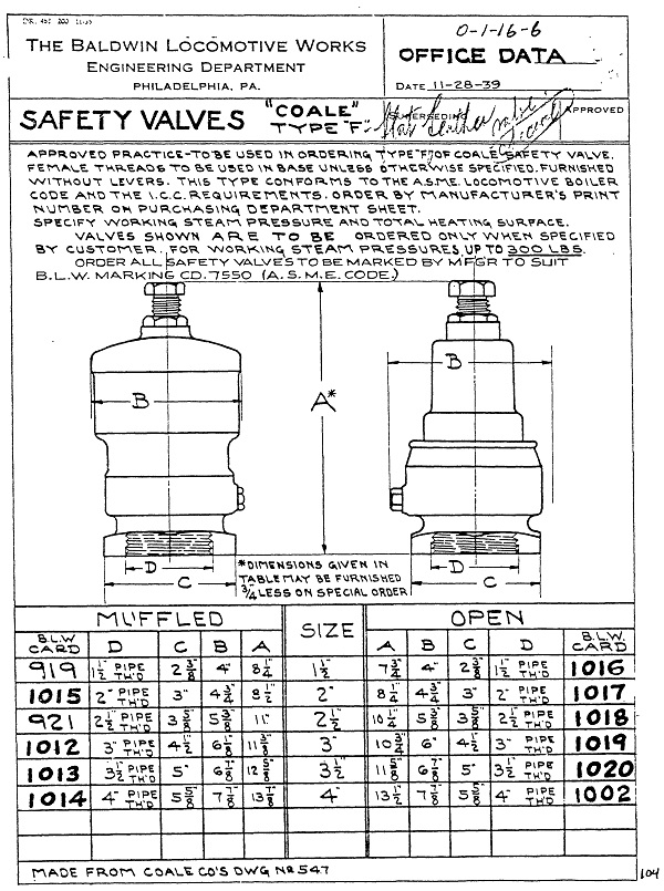

Does anyone have access to anything from the Coale company in the way of trade publications, drawings, photos, or sales catalogues about their safety valves? I have two different pairs of Coales valves that probably date from around 1912 with no details about what models they are or the specifics about them.
I have done a google search and have all the patent info and two photos, but more photos and other material about the safety valves they made would be fantastic!

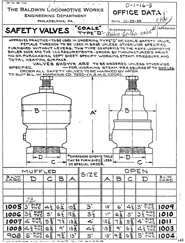

Here is some information from the Baldwin Standard Practice Vol. 1 CD, published by the Engineering Standards committee.
Hope it is of some help.

Have done some rearranging, so here's another try.
Many thanks to Kelly Anderson and PMC
Dave
