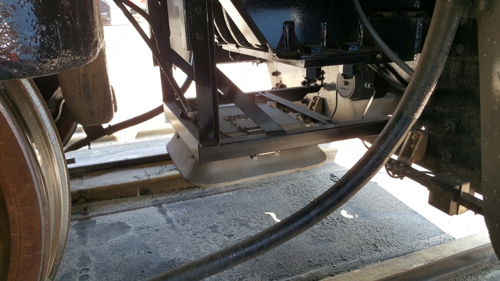

While there is a radio antenna that is mounted on top for the purposes of receiving data (receiving temporary speed restrictions), the antenna that Mr. Cook is most likely referring to is the large ACSES receiver antenna that hangs underneath the vehicle. This antenna is used for reading the transponders which are permanently mounted in the gauge of the track, which provides data to the onboard equipment so that the system knows where the train is physically located on the railroad and at what speed limit that train should be operating.
In the picture below, you can see the cab signal track receiver coils which are directly behind the pilot plate. The large silver box hanging from the bracket is the ACSES antenna which reads the transponders. On this particular locomotive, the ACSES antenna is mounted under the F-end nose, however these antennas can be mounted almost anywhere on the underside of the equipment, they do not have to be on the leading end of the equipment in the same manner as the track receiver coils.
