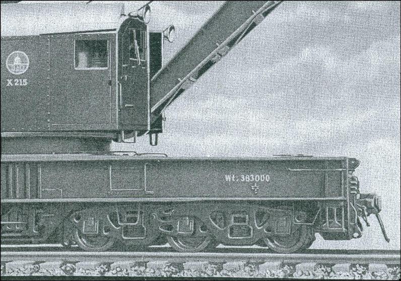

The attached photos are scanned from a page believed to be an Industrial Brownhoist promotional calendar.
Being a fan of IB cranes, I’ve looked at quite a few wrecking crane pictures but have not seen this one before.
I’m thinking the rendering depicts X215 as it likely appeared when it left IB’s test track. (I don’t know.)
It looks like B&O X215 gained some extra weight over its career too.
John

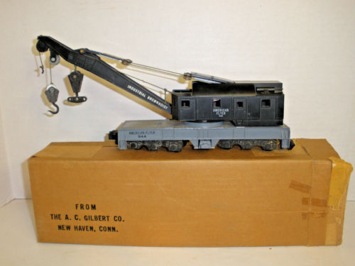

Thanks. I just realized that this must be the prototype for the American Flyer Crane--and all along I thought they used a steam crane

The American Flyer 944 toy does have the same revolving superstructure and boom as the X215.
The window(s) on the back of the 250-ton diesel cranes are a helpful identifier.
The back window on the toy and rear window on the X215 are the same horizontal pane arrangement.
Later diesels have two vertical windows on the rear of the cab housing.
For whatever reason, A.C. Gilbert fitted their toy crane with what appeared to be Commonwealth trucks
which I don’t believe were ever installed on any real IB crane.
(I’d love to see a real IB crane, or photo of wrecker with commonwealth trucks installed if it’s out there.)

The AC Gilbert crane uses Buckeye trucks because ACG was famous, or rather infamous, to use what was on hand. These trucks were used under their Hudson and Northern locomotive tenders, and the only other 3-axle truck they had at the time was a stamped tin passenger car truck. They probably figured the Buckeye was more appropriate and believable.
