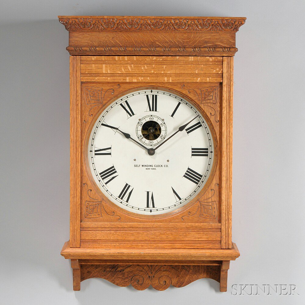

Bernie, this is what the clock in Bank Tower looked like.
Keith
self-winding-clock-company-no-10-oak-gallery-clock[1].jpg [ 177.53 KiB | Viewed 9509 times ]

I thought that railroad clocks, like railroad watches, were required to be marked with Arabic numerals?
 Post subject: Re: CNJ Tower Clocks
PostPosted: Thu Jan 19, 2017 10:14 am
Posts: 215
That only became a requirement fairly late in the game when standard time zones were created. I have a pocket watch specifically made for railroad service that not only has Roman numerals, but it was a hunting case watch. Both of those features were later banned when watch requirements were codified. That plus the fact that standards were set individually by each railroad. There was never and industry wide standard for watches and clocks.
Keith

Guys,
Thank you for all the above information. The information on the movements is a little mind boggling because I am new to these types of movements. I enjoyed the video and will look at it a few more times. That is a beautiful clock.
Bernie
