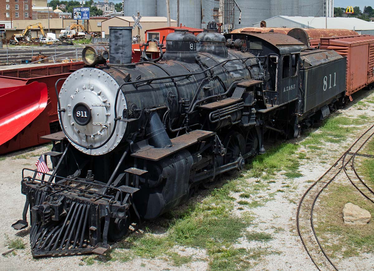

Lately I have been helping to develop a plan for doing some restoration work on former Atchison Topeka & Santa Fe 2-8-0 #811 in Atchison Kansas.
From what I can tell, the Santa Fe made a point of removing the eccentric rods from every locomotive that it donated that had Stephenson valve gear. 811 is no exception.
In looking at various options for a cosmetic restoration of 811, the idea of replacing the missing eccentric rods is being explored. A goal of the restoration is to make some or all of the appliances functional with compressed air, and possibly even occasionally move the locomotive a short distance with air.
Has anyone had to have eccentrics made for a locomotive recently or otherwise have a rough idea of what it might cost to have them made? (not looking for an exact detailed quote, just a ball park figure to help determine if the idea is even feasible)

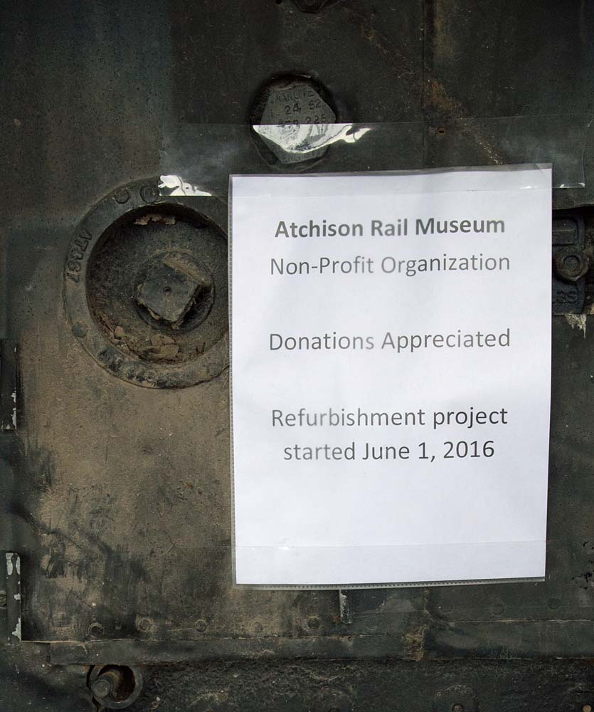

I'm happy to hear about the effort to refurbish AT&SF 811. I visited it in July and found this sign taped to the backhead. Unfortunately I wasn't able to find anyone with additional information. One of the display cars had been vandalized the previous night with paint. Understandably, the people connected with the museum were busy trying to correct that issue.
Jeff Terry

Good looking Consolidation! Some facts:
Built by Baldwin February 1902 s/n 19967.
Donated to Atchison in 1954. Although apparently kept outside since then, she still looks fairly decent, although obviously in need of some paint in addition to the eccentric rods. Hopefully that paint will soon be coming.
She has one of those interesting, and unique, Santa Fe oil tenders. Never could quite understand their design. I stopped by the museum in Atchison a number of years ago. They seemed to have a very nice collection of equipment. Also note the live steam (?) track.

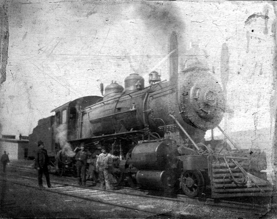

My great-great-grandfather was a fireman and brakeman on the Santa Fe from 1899 to 1943. One of his hobbies was photography, and he took a photo of no. 811 sometime between 1902 (when it was built) and 1907 (when I think it was simpled). The photo was probably taken in Albuquerque. I think my great-great-grandfather was standing behind the camera, as he's not one of the men in the photo. Sadly, I think that the photo was not exposed or developed quite right, and the past century has taken its toll on it too, so it's a bit hard to see details. It's still a cool photo though.
I wish you the best of luck working on the 811!

6-ET wrote:
Very cool photo!
I don't recall ever seeing a larger top chamber of a steam engine cylinder. Has the arrangement of the valve and driving pistons been reversed on this particular locomotive?

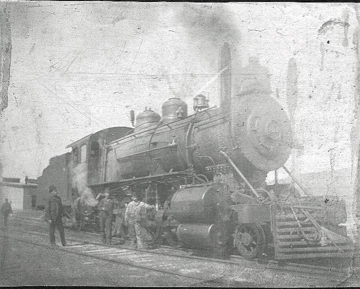

Two minutes in Photoshop Elements later:

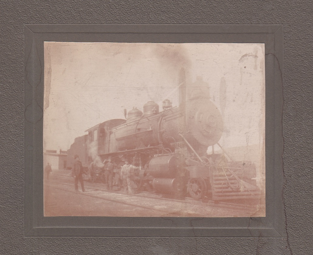

Not to out-do Alex #4, but I too ran the image through Photoshop with this result.
The original silver nitrate print can be professionally restored, and you might wish to look into that option, as it adds provenance to the locomotive on display.

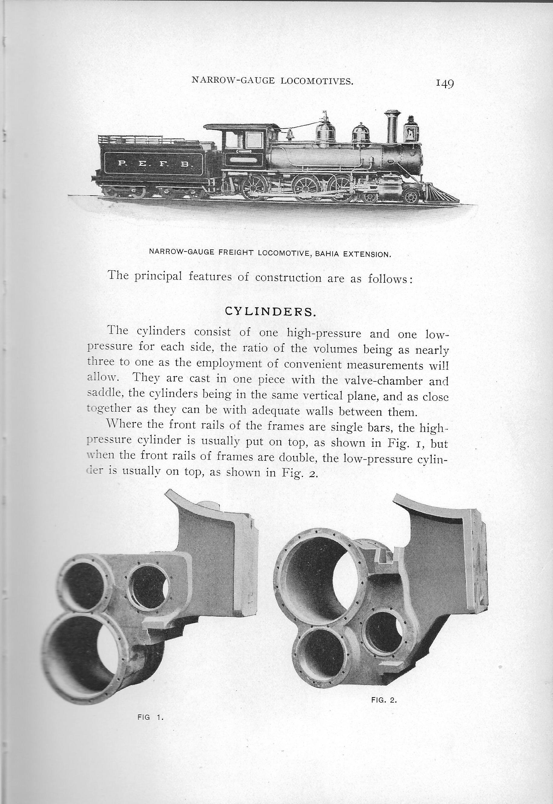

At the risk of moving away from the cost of eccentrics... but following the discussion about compounding...
A page from a 1900 Baldwin Narrow gauge catalog... on Compound cylinders
File comment: from Baldwin Locomotive Works Illustrated Catalog of Narrow-GAuge Locomotives, 1900
