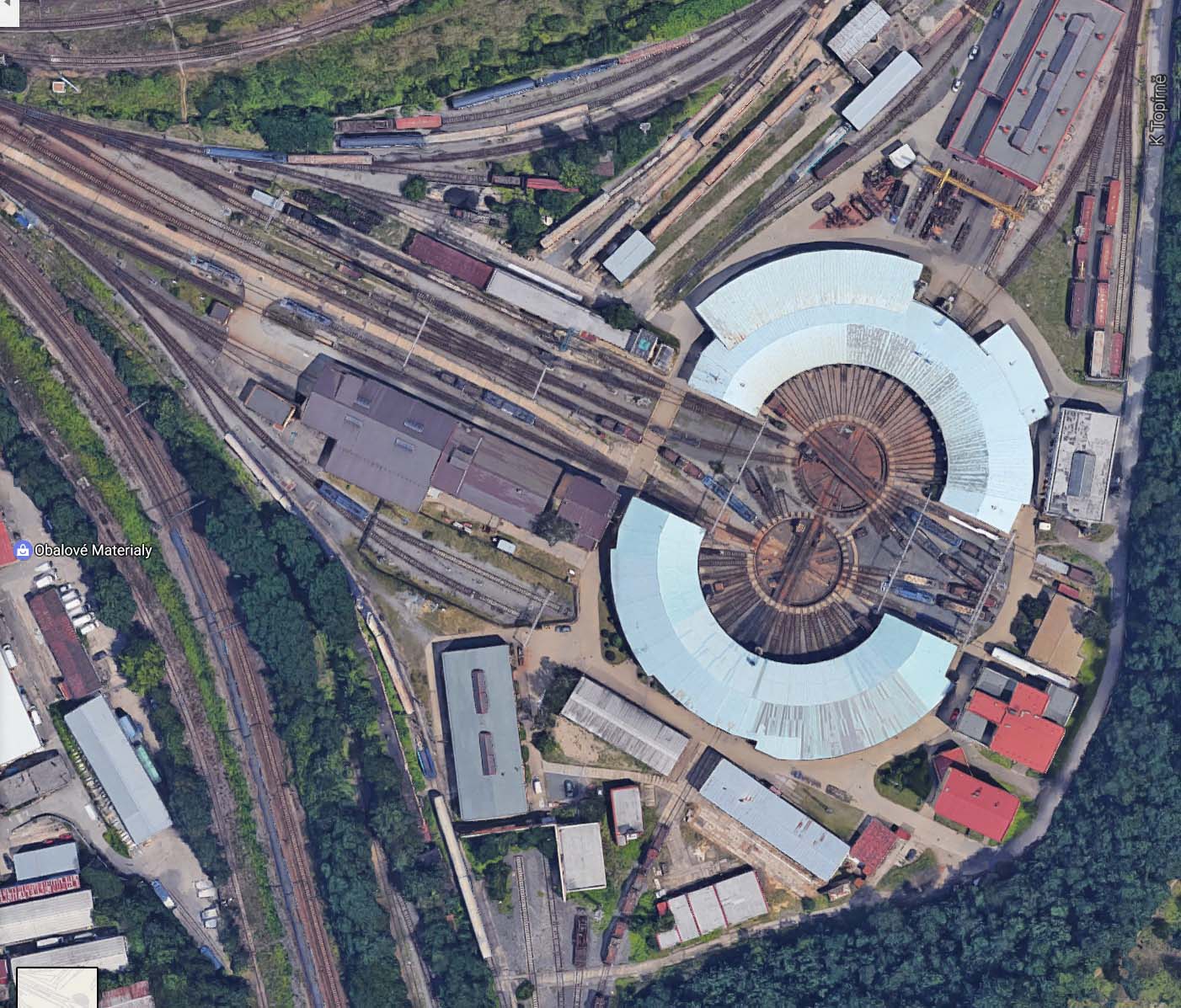

where was this -double turntable- that was sorta interleaved into each other somewhere I think was posted here not too long ago? perhaps not the largest but certainly unique...
 Post subject: Re: Largest Turntable in the World?
PostPosted: Sat Dec 31, 2016 5:23 pm
Posts: 914
Hi,
IIRC, there were only two - both in Germany. The set up was that the original turntables could align and transfer a loco from one to the other directly.
When new longer power came, the turntables were both lengthened and became interleaved. The need for throughput was the controlling factor - they could not move power through fast enough with one table. The ability to transfer power between tables was an added plus. Sort of like double tracking a mainline.
Doug vV

Dougvv wrote:
Hi,
I don't know about the two in Germany, but there is one in Prague, Czech Republic. Not only that, it appears to still be in service! In fact, this whole area looks like a model railroad, check it out on Google Maps, it's amazing.
https://www.google.com/maps/place/Pragu ... 14.4378005
