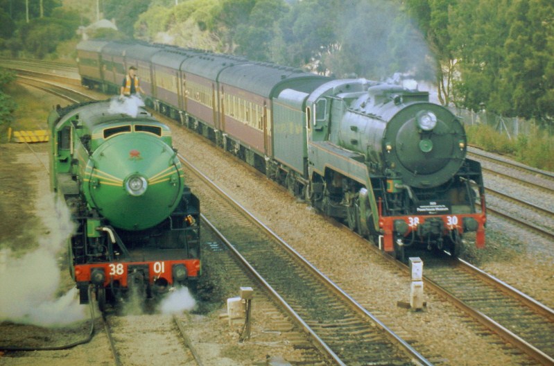

I quite like the "semi streamlined" version of the class - as shown by fellow preserved #3830.
The pair are seen at Maitland Steamfest in New South Wales back in April 2004.
Managed trips from Sydney to Maitland in 2003 (3801) and 2004 (3830) - both memorable trips, though I doubt whether I will make the journey to Australia to see either of them again.
