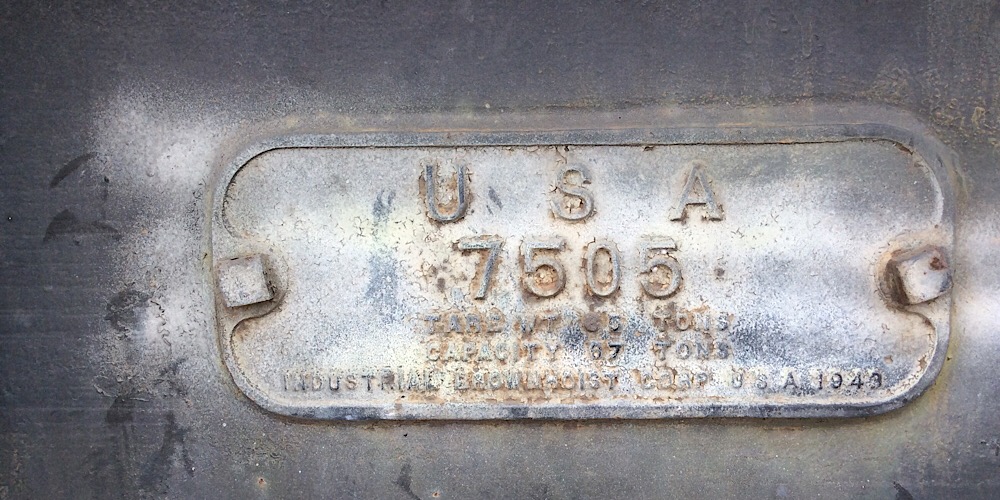

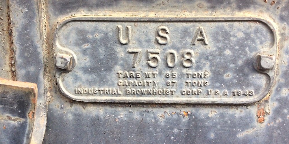

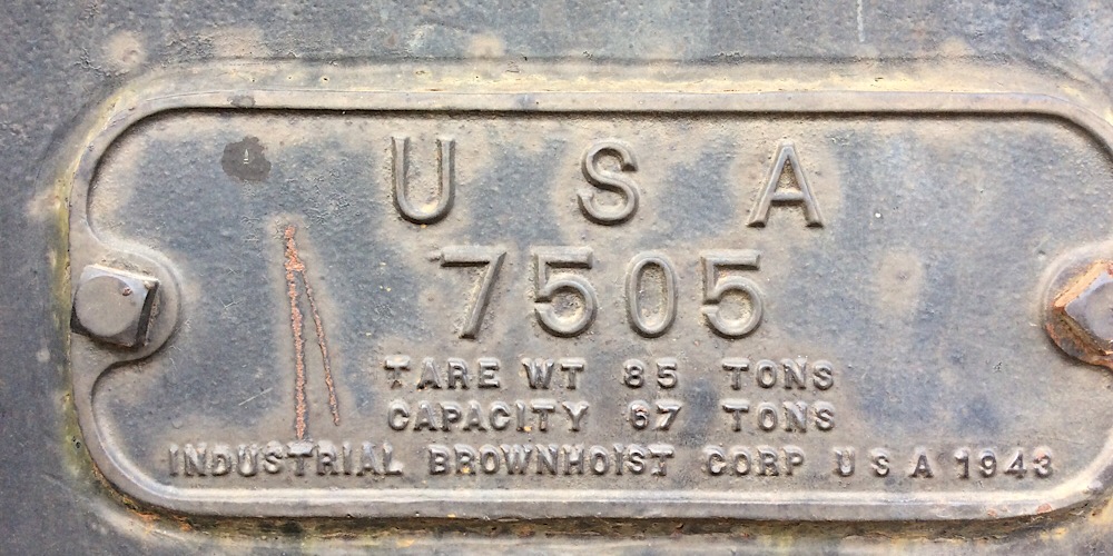

Does anyone have any contacts at or near the Museum of Alaska Transportation & Industry at Wasilla? I am trying to get the builder's numbers for their two Alaska RR wreckers. All the information should be on US Army Transportation Corps plates riveted to the car bodies. After several attempts to contact the museum directly I have given up on them.

Thank you Art and others. I drew up the ARR crane list that is on the web site. 7505 and 7508 were the US Army numbers for the cranes. Information from the Industrial Brownhoist records has throwen doudt on the stated builder's numbers so I asked for a check of the plates. With any luck this will settle the matter.

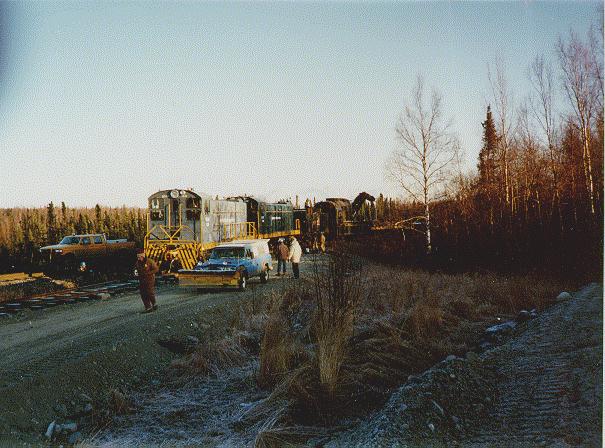

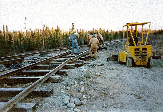

I can offer a couple of photos from the day they arrived at the Wasilla site in the early 1990s. Taken looking railroad south with the ARR main to the left. The ARR main line was closed for 6-8 hours to realign the rails to move about 25 items of rolling stock and locomotives onto the new site.

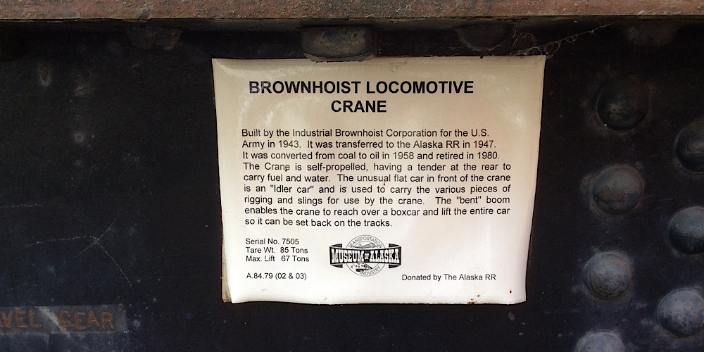

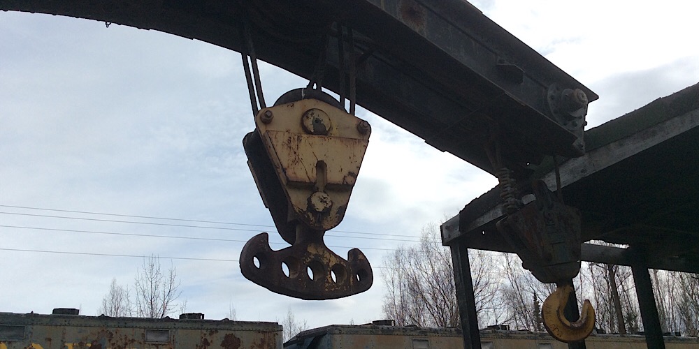

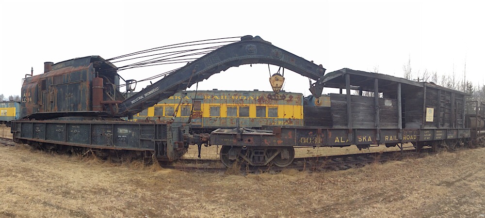

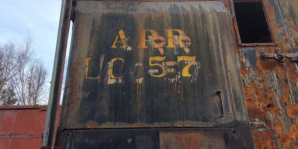

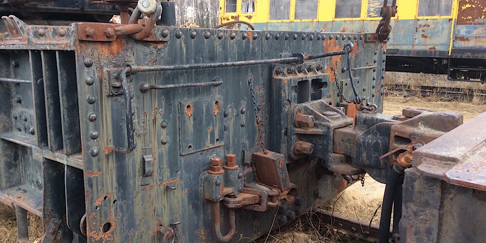

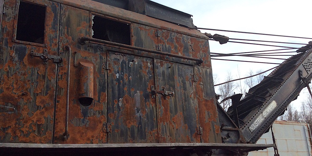

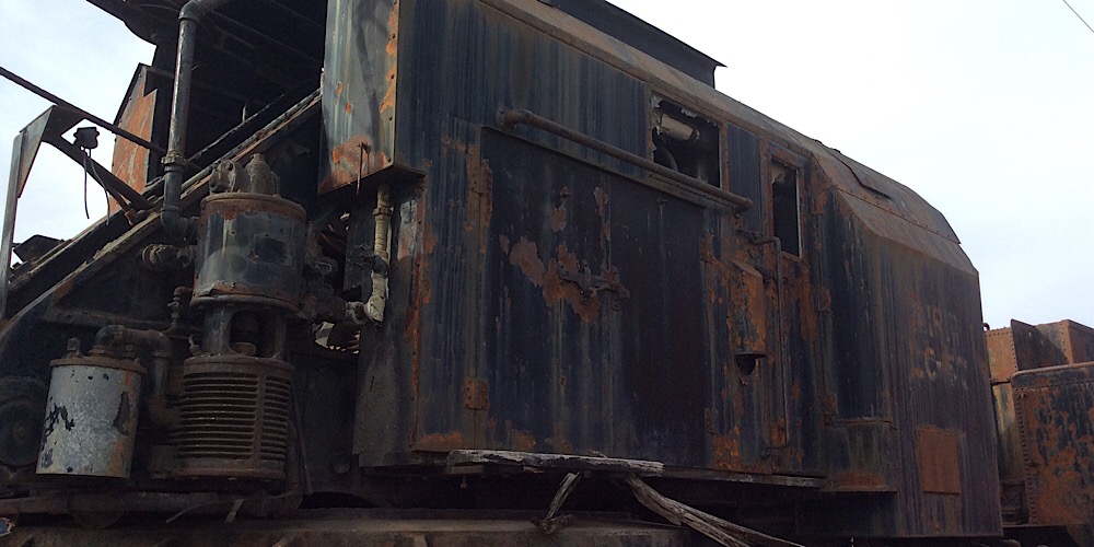

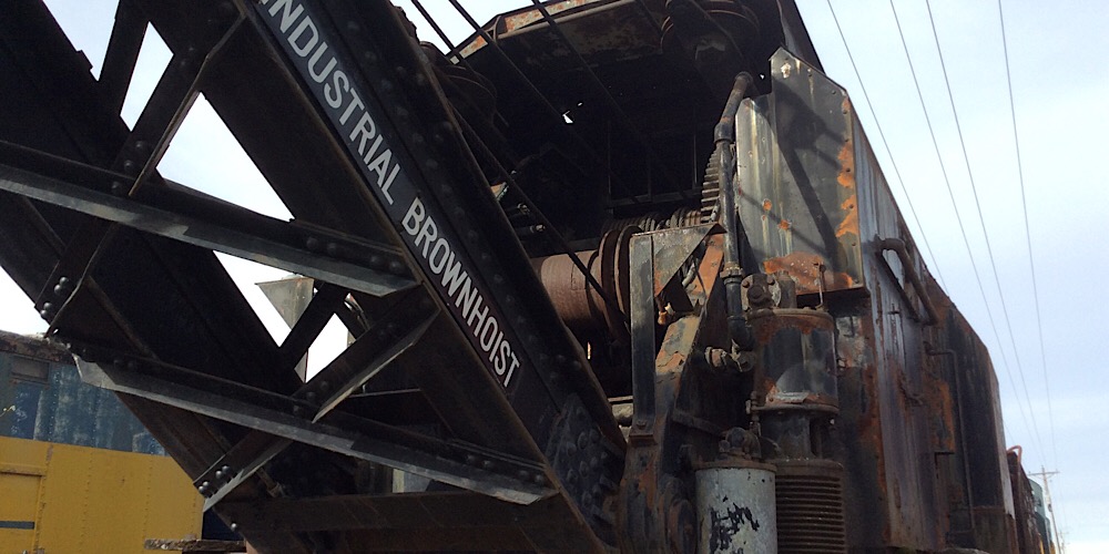

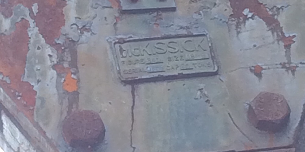

John, weather cleared, my scheduled made it happen, sorry it took so long. Here's the photos of the cranes. Will start with 7508. ARR LC-57
File comment: LC-57 a
File comment: Plate
File comment: LC-57

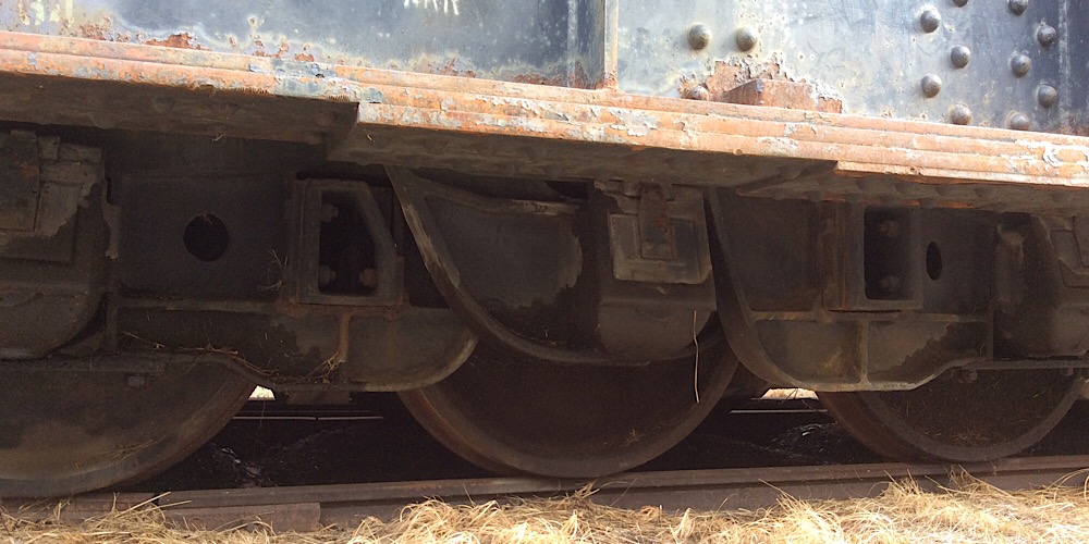

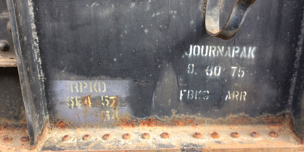

 Post subject: Re: Alaska transportation museum
PostPosted: Thu Apr 27, 2017 1:49 am
Joined: Fri Sep 10, 2004 3:52 pm
Posts: 91
Location: North Pole, Alaska

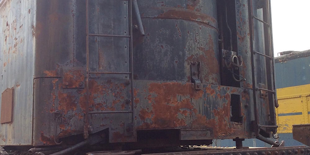

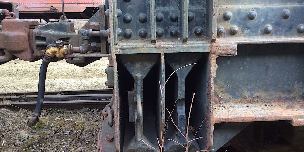

Part 2
PostPosted: Thu Apr 27, 2017 1:51 am
Posts: 91

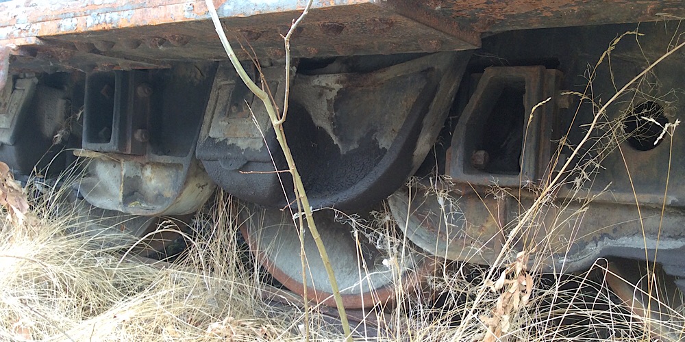

Part 3
PostPosted: Thu Apr 27, 2017 1:53 am
Posts: 91
Part 4

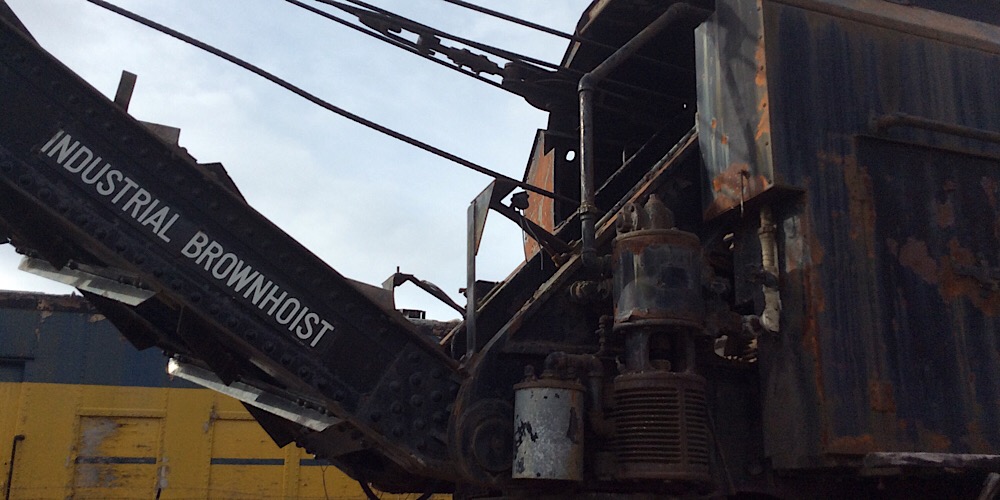

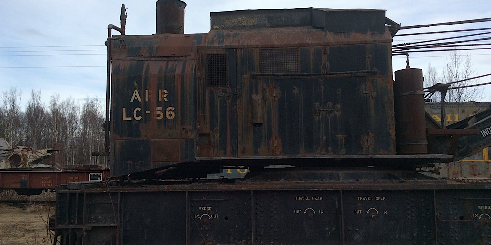

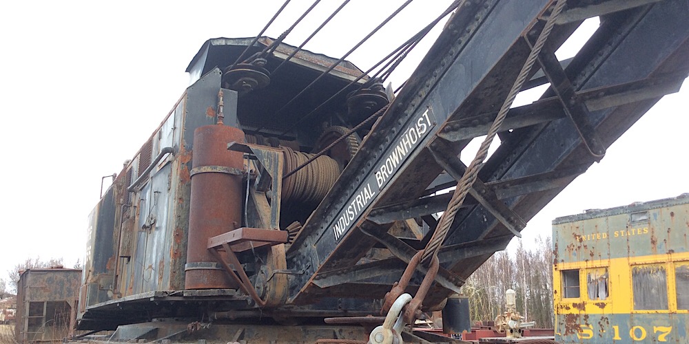

PostPosted: Thu Apr 27, 2017 1:57 am
Posts: 91

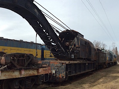

And now pictures of 7505, LC-56.
PostPosted: Thu Apr 27, 2017 1:59 am
Posts: 91
Group B
PostPosted: Thu Apr 27, 2017 2:01 am
Posts: 91
Group C
