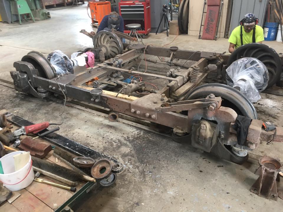

Hello all,
For the last 3 weeks I have been Helping restore the Sacramento Northern Birney Safety Car 62 at the Western Railway Museum. We plan to get this car back in service after being unused for a few years now. We plan on rebuilding the suspension, roof, motors and giving it a more accurate paint scheme. More Historic info here: http://www.wrm.org/downloads/wrm-fundra ... summer.pdf
Here I show us removing the tar the SN applied to the truck

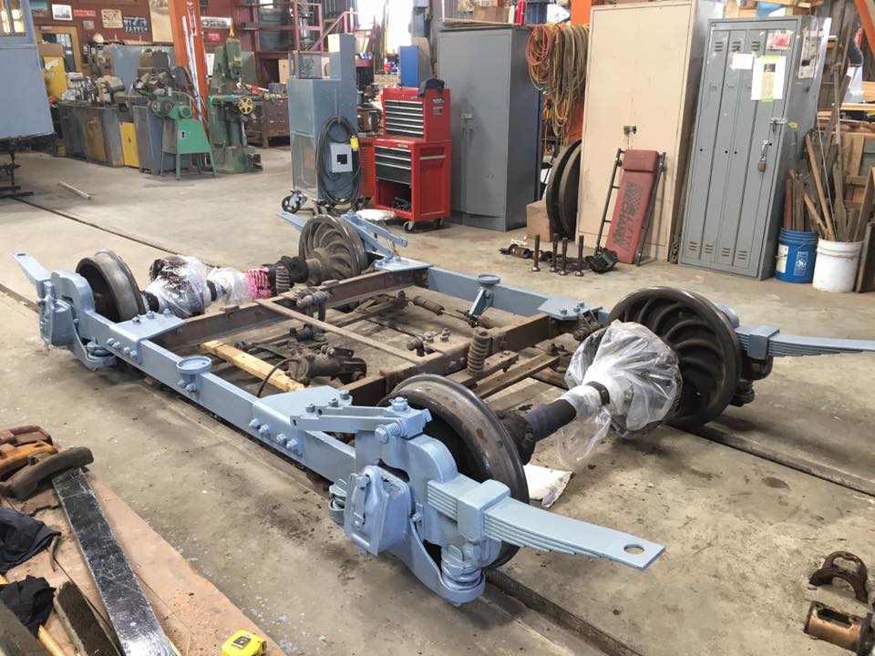

Instead of tar we will be just painting it black

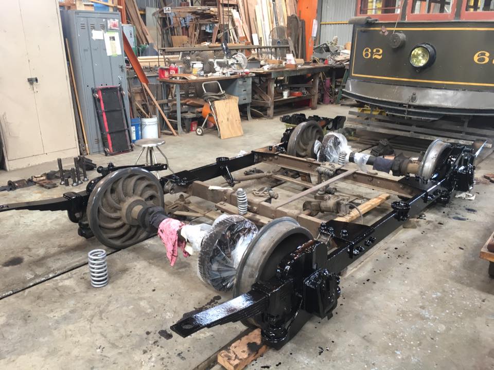

The Newly painted truck looking real good after 3 weeks of prep work.
More parts of the suspension are being worked on now and the motors will be sent out to be rebuilt soon.

What is the story with shat looks like it may be a rack and pinion brake cylinder (cylinder on 2X4 with small rubber hose running over the near frame) in the first few photos. Then it looks like there are shock absorber like snubbers next to the far frame.

Looks like an automatic slack adjuster, not a type I am familiar with, though. Most I've seen or worked on are Westinginghouse E or J types.
Gord M
 Post subject: Re: Sacramento Northern Birney Safety Car 62 Restoration
PostPosted: Thu Nov 03, 2016 9:49 pm
Posts: 650
Gord is right, it's an automatic slack adjuster.
It is a J.G. Brill slack adjuster, not a Westinghouse.
I can't find the model number or other information right now.
I just tested it yesterday, and it works.
Rich:
The "snubbers" are brake release springs. They have tapered windings on each end to enclose the tapered endings of the rods which attach the spring to the brake beam and to the frame of the truck (where the adjusting nuts are located). (One spring, visible in Ryan's top photo, is a replacement which does not use tapered windings to enclose its end hardware)
The truck has seen a lot of repairs in its service life.

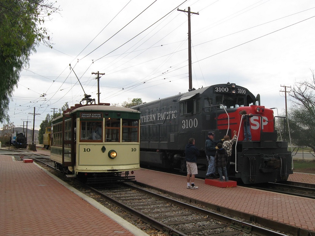

It's interesting to note how many Birney cars (and similar models), which were built for light weight and low cost, and were, in some cases, the last cars bought before their streetcar lines were replaced by buses, have survived into the 21st Century. According to the Preserved North American Electric Railway Cars website, 82 still exist, with 11 reported to be in "operable" condition, and 7 are in process of restoration.
File comment: Former Pacific Electric Birney 332, in its Tucson 10 paint job with ex-SP U-25B 3100 at Orange Empire. Both the car and the locomotive have GE traction motors.
