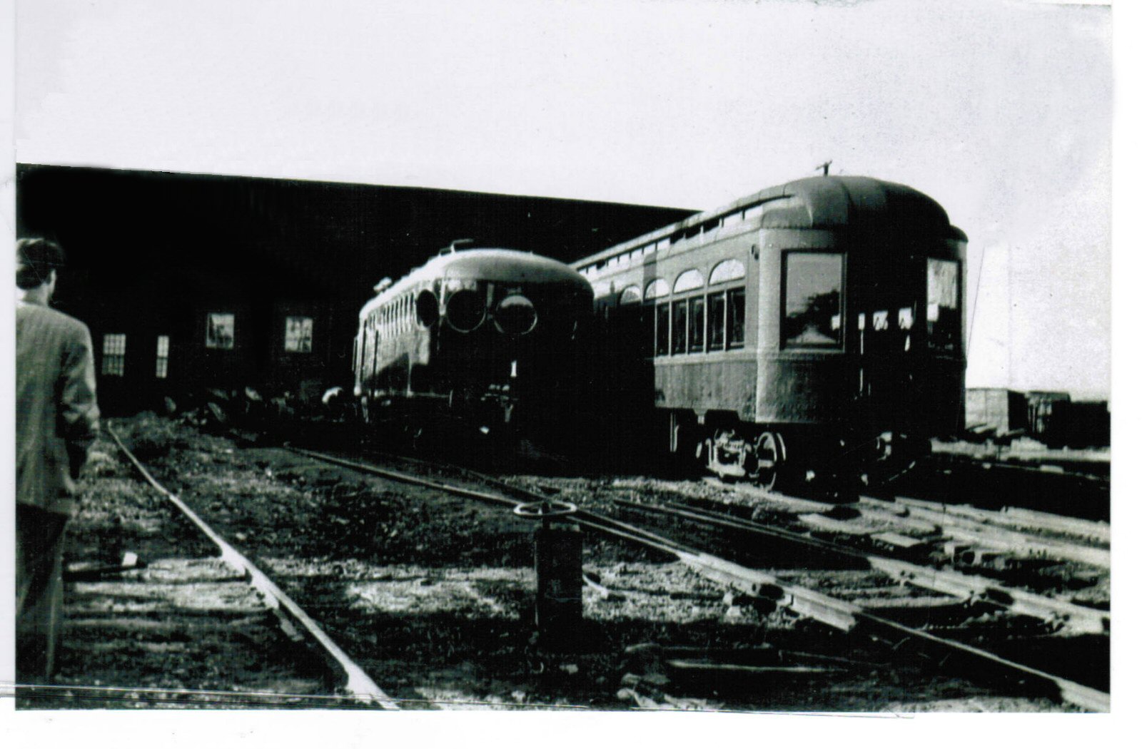

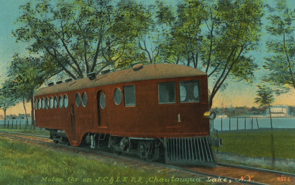

I can assure you that the Viele Car was different from the McKeen Car, Photos of the C&LE McKeen are attached. The car was originally Hocking and Sunday Creek #1. It weighed 30 tons, could haul about 54 passengers. It also had a small baggage area in the front for the passengers.
If you have any questions about McKeen Cars in particular, or other motor cars in general, I may be able to answer them.
