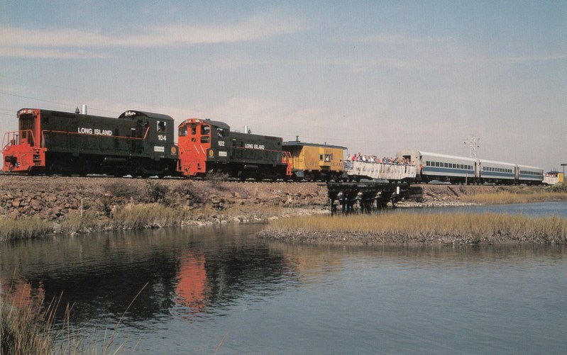

It can be done as proven in the past. I do remember seeing footage of BR&W #60 here on Long Island in the 1960s and what a money maker that must've been for its time. The recurring problem again is resources and whether its some little short line or a class 1 doing the operation it cost a tremendous amount of money, equipment and most importantly labour. You'd think with the amount of antiquated equipment a place like Steamtown or the IRM has a separate entity could perhaps lease a couple of cars and an engine for day. Well it's sure not what it was back then and I doubt the MTA let alone any other transit agency would be so willing to take on the task of the insurance expenditures god forbid anyone file a lawsuit.
