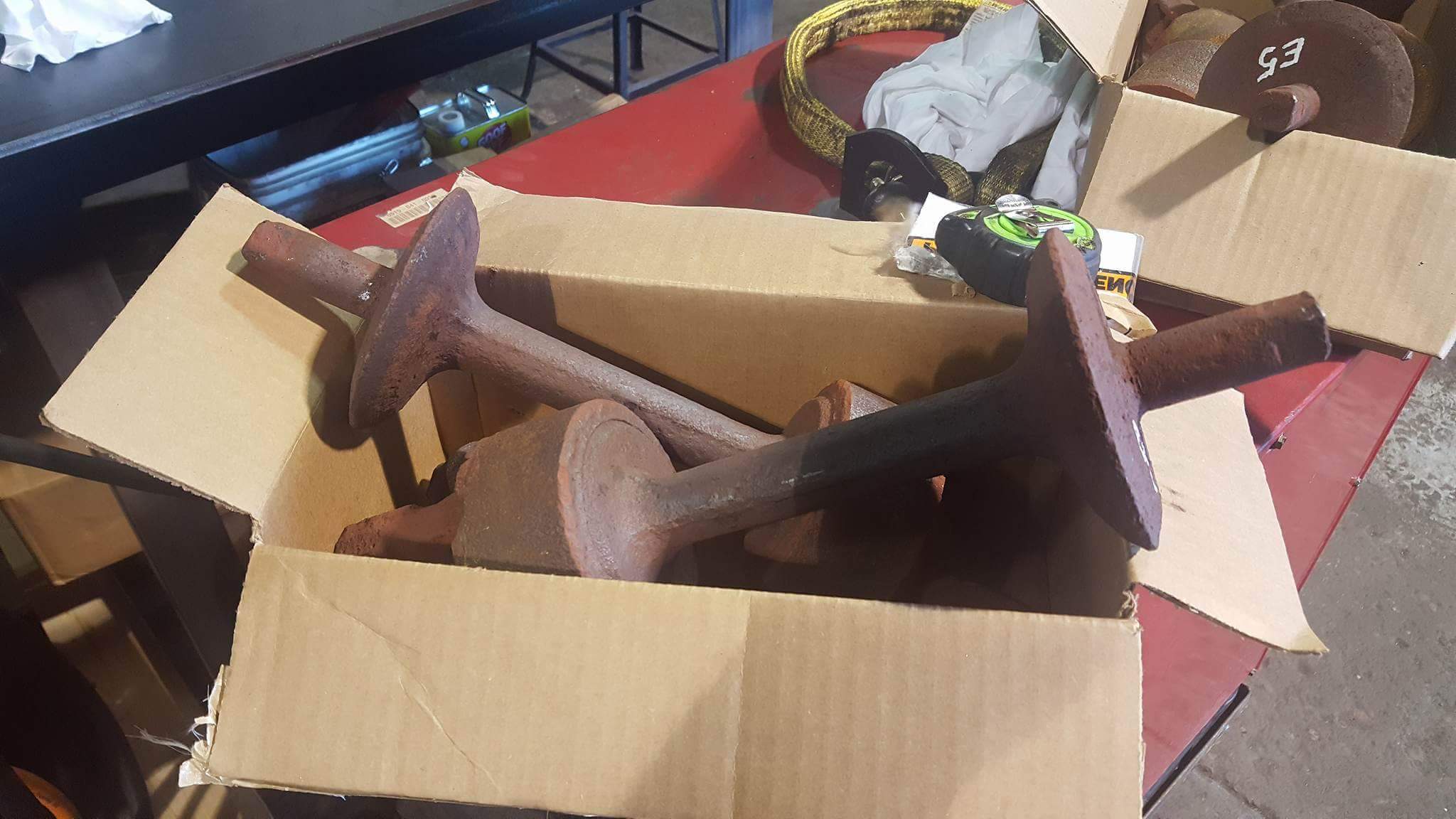

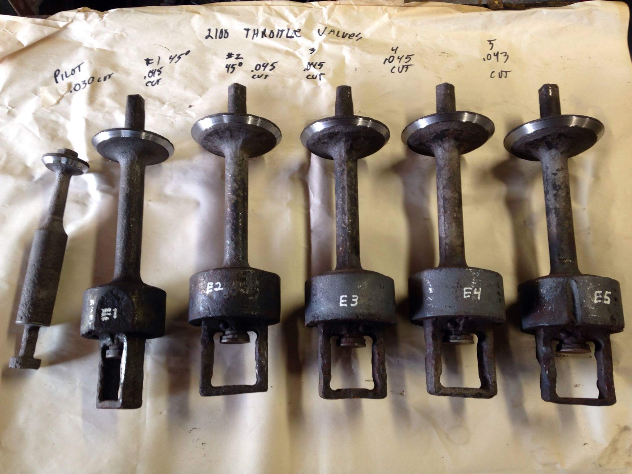

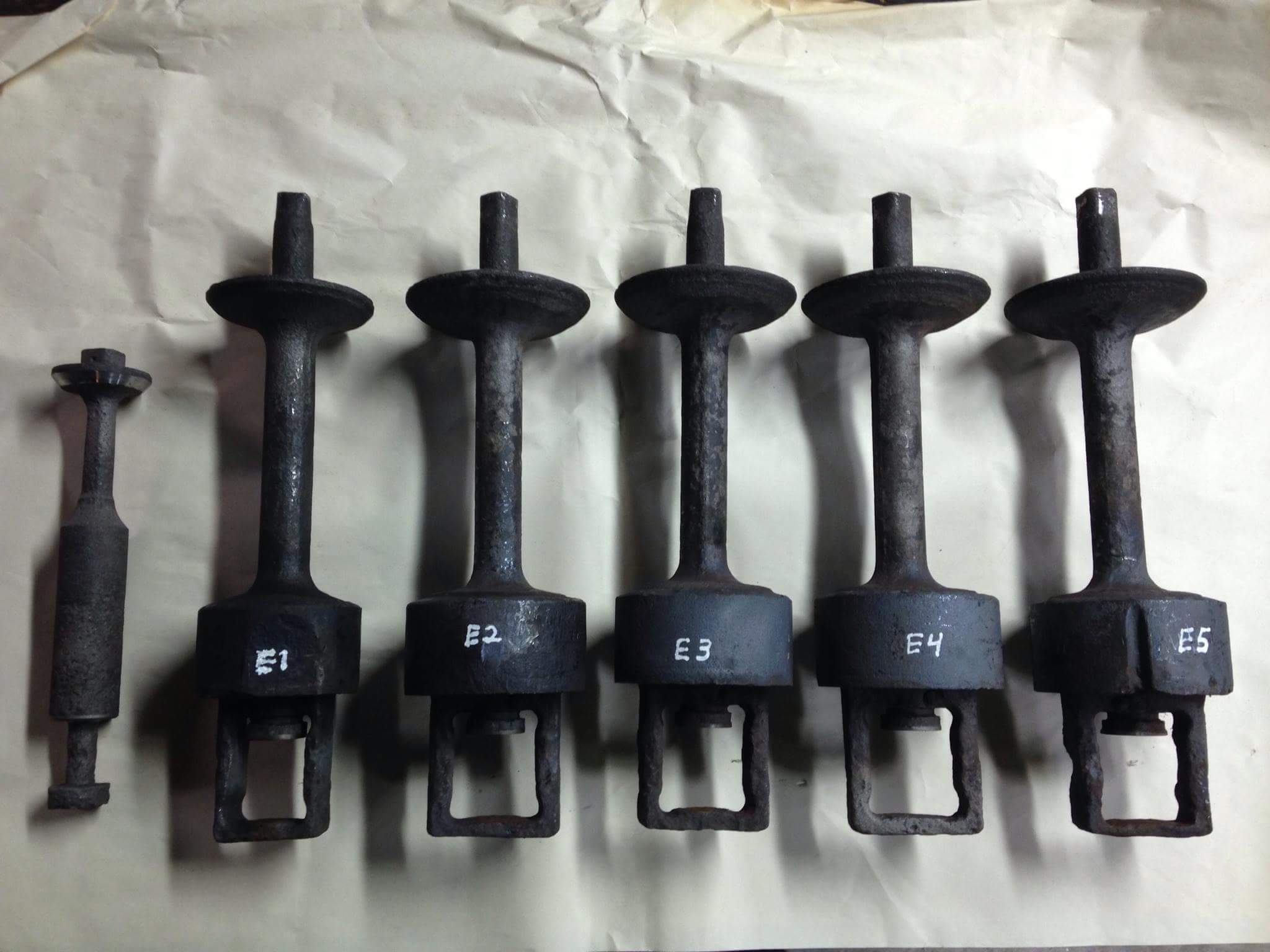

Thought we would bring you this pre-weekend update. Dan Pluta sure was a busy beaver this week. Git her done, Dan. The pilot valve and all four (4) throttle valves were removed last weekend from the throttle assembly. Take a look at how worn the valve seats were. Dan cleaned them up and cut new valve seats and carefully documented the amount of material removed in the process. Tomorrow, lapping of the mating valve seats in the throttle body will take place.
Stay tuned for Part II...
Sincerely,
Rob Gardner
ASR Chief Engineer and Fundraising Chairman
File comment: Check out these rusty relics. Not for long.
File comment: Here the throttle valves have been cleaned up and prepped for machining.
File comment: Wow. Check out those freshly machined valve faces. Nice work, Dan.

And the 2100 ran with those valves, in that condition?

How, apparently that is the case. Kind of surprising, huh?

Seems it was a good call to address this now. My little experience with steam locomotives is they are or can be very forgiving when you find things that need to be rebuilt or replaced. Not promoting running substandard equipment but the truth is steam locomotives can run a long time with leaky valves, worn valve gear, incredibly worn seats on steam delivery systems. Broken frame members, working cyl, egg shaped cyl, broken piston rings, worn packing glands missing parts and the list goes on. Admit the pictures look horrendous. Wouldn't of thought the valves would of been so rough in appearance? Never really know what you'll find when you start looking around, guess that is why we look. Thanks for the updates. Regards, John.
