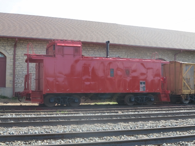

As stated in a previous post, I am working on AT&SF 999952 in Atchison, Kansas. I painted the car yesterday and now I am trying to track down a couple of 1970's relics to finish it;

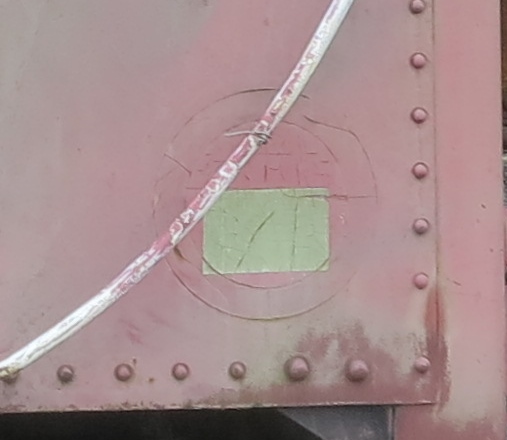

- The car had four 4" X 6" reflective spots on each side (photo attached). These are not the modern honeycomb looking scotchlight. They look like reflective tape of some sort. Does anyone know of a good way to replicate them? I am redoing the caboose in its last paint scheme (1976) and don't want to go with the modern, honeycomb reflective tape. (car is not going anywhere so meeting current rules is not of any concern)

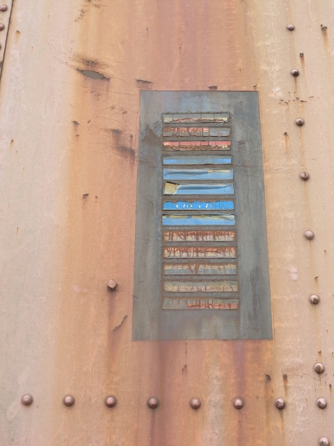

- Has anyone redone the 1960's / 1970's optical scanner blocks? Is there I guide any where that shows what information they should have and what color tape was used? (oddly, the tape used on these blocks is the honeycomb style, I just want to get the colors right). I did not paint over them and am not planning to unless I can figure out how to accurately redo them. A photo of one of the blocks and the freshly painted caboose is attached.

This should help with reproducing the barcode.
https://en.wikipedia.org/wiki/KarTrak
JR

Are you sure the older solid color Scotchlite isn't still available? This outfit seems to have something that will fill the bill, 15" wide and sold by the foot.
https://shop.novoworks.com/3M-Scotchlite-Reflective-Vinyl.html
Disclaimer, I have no experience with these folks, just the first good hit on the web.
You might want to talk to a sign shop that has a vinyl cutter; they should have a similar material, and could pre-cut the "circle crosses" from a good tracing.
On edit:
Be aware that those circles had a black detail inside which mimicked the railroad's logo. I suspect the black was non-reflective, silk screened on the Scotchlight. Sand through one to find out.

Dennis, looks like the scotchlite you found will work perfectly, thank you. For better or worse, I don't have to worry about the cross in circle reflectors, the Santa Fe painted them over last time they painted the caboose (1971) and put the 4x6 rectangles over them.
The Kar Trak tag was in place before 1971 as it was masked over when the car was painted then (last coat of Santa Fe paint was higher than the black of the tag) Almost hate to re do it.

 Post subject: Re: Trying to get the details right, AT&SF Caboose 999952
PostPosted: Mon Sep 05, 2016 9:01 am
Posts: 2077
Jason,
Sorry for a late reply. Have you looked into local sign companies that do cut vinyl? They can either print on reflective material to make multi-color appliques with a reflective background or apply cut vinyl over Scotchlight. Also, to make masking easier, they can cut your design with a masking material that you stick on the car as a sheet and then peel off the top layer to leave a perfect mask for painting. They usually require .ai or .eps files for printing/cutting or you can pay them to do the design.
