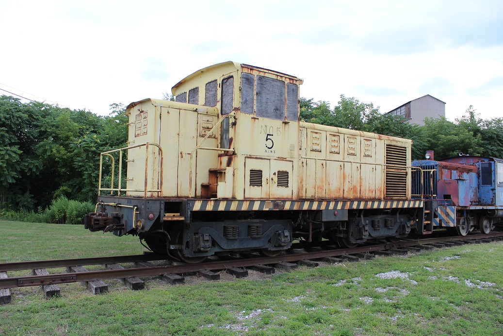

I did not know that the MVRHA's unit was so rare. Its complete, so with a moderate amount of work I think it will run again.

Just as a heads-up, the five I-R and five Cooper-Bessemer New Haven switchers were built for the NH 1936 as class DEY-1 and DEY-2; the five C-B units (DEY-2) were sold to BAR in 1951, the I-R locos to Republic Steel (0906-0909) and Atlantic Coal Co. (0910).
They are NOT the same as these offset cab locos (45 and 60 ton) seen here, built for the military during the Second World War. The NH locos had the radiator in the short hood, and the military ones had the radiator in the long hood as seen on #5 above.
The NH/BAR CB's were 8-cylinder 10 1/2 x 12, and I think the same engines were used in the wartime locos. Maybe Brother Rowlands can confirm by looking in the one at MVRHA?
