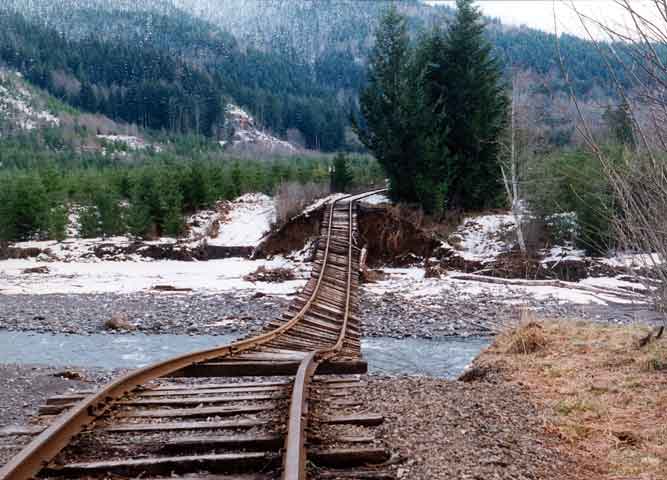

PostPosted: Thu Aug 25, 2016 3:19 pm
Posts: 3013
bbunge wrote:
... a better understanding of the threats in your area (Just not severe weather, but also flash flooding as an example).
Flash and regular flooding are indeed threats. Imagine coming around a curve and seeing this where solid ground or your bridge approach used to be. It's happened twice now to a certain well known RR in the Pacific NW. Other railroads in the area have also had problems with track washouts.
