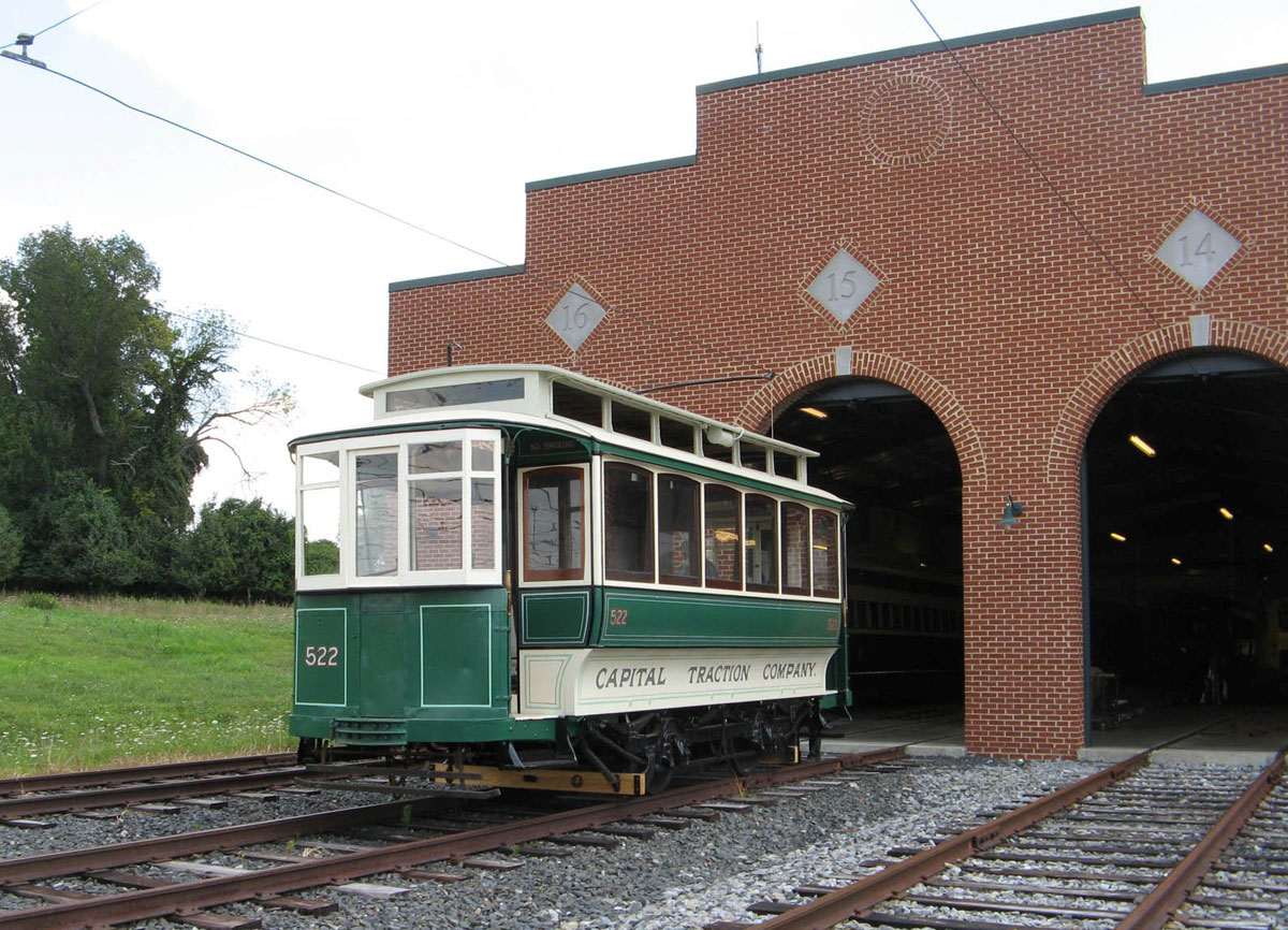

Capital Traction 522 (American Car 1898) moves outdoors for the first time following restoration and reconstruction of the body and truck.

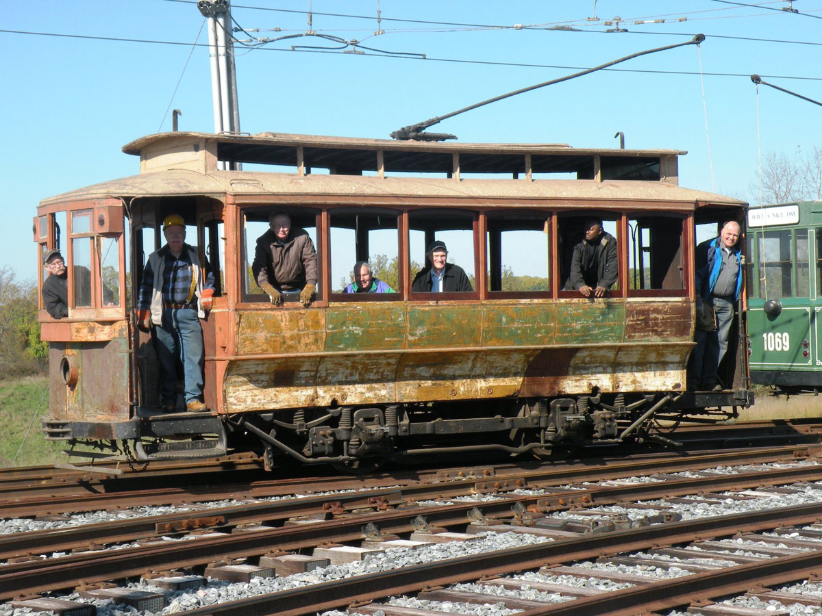

The body restoration and reconstruction was done by Keith Bray. Lyons Engineering reconstructed the truck using Lord Baltimore truck side frames donated by our friends at the Baltimore Streetcar Museum. The car is operable as shown here. The original interior was gutted by Capital Transit in the 1930s. Here is a picture of the car before work started in 2014.

What was wrong with the truck in the "before" photo?
Where is the headlight?

CTCo 522 was built with a Lord Baltimore truck. When the Company converted the car for service as a grinder in the late 1930s, they swapped out the original truck for a Brill 21E shown in the "before" photo. When Keith Bray started work, he discovered the Company had made multiple cuts in the original wood frame to accommodate the Brill truck. In addition, the clearances of the Brill truck raised the level of the original floor line of the gutted passenger compartment. With cooperation of the Baltimore Streetcar Museum we were able get the car body back on the correct Lord Baltimore truck frame.
The original headlight was a portable lamp that hung on a bracket on the dash. The headlight fixture shown on the "before" photo is what remains of a Golden Glow fixture installed for workcar service.
The portable vestibules (windshields) were installed in 1905 following an order by the public service commission eliminating open platforms on all Washington streetcars. Since Capital Traction 303 is displayed at the Smithsonian as an open platform car, we decided to retain the vestibules to interpret the 1905 modification.
Curiously both 522 and 303 owe their preservation to the introduction of the PCC in Washington. CTCo 303 was brought from storage and operated as a relic when the PCCs were introduced in 1937. Early on, the Company discovered the PCCs were corrugating the rail when accelerating from stops. CTCo 522 was converted as a grinder in the late 1930s to make repairs to the damaged rail.

Wow, you guys did an amazing job! Just curious, what is that tank under the deck roof by the 4th window used for?
Looks like the choke coil; used in conjunction with the lightning arrestor to attempt to protect the electrical equipment from lightning strikes.

Ah, that sounds like a good idea. Thanks!

It's a great looking car - nice work! That anticlimber is a real kick on such a small car.
