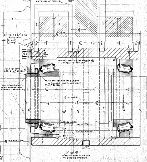

Its time to start refurbishing the J&L 58's roller bearing driving boxes. I do not know what oil Porter originally specified for the application, or what is commonly used so I am asking here. Just two Timken tapered roller bearings inside rotating at slow speed.
What grade of oil should I be using? Thanks

Wouldn't Timken be the best source for this information?
 Post subject: Re: Correct Oil for Roller Bearing Driver Boxes
PostPosted: Sat Aug 06, 2016 10:55 am
Posts: 841
85W140 EP is what Timken recommends for oil-lubricated roller bearings.

Thanks! That is good enough for me!

I think the heavier oil would also stay in place better than a light oil. Note how close the max oil level is to the grease grooves which denote the space between the box and the axle. It doesn't take much of a cross elevation for oil to start leaking past the seal and onto the track. This grease seal area was also what was giving me grief when we tried to get the wheels turning, as it had corroded and froze the axles solid to the box.
Being unable to inspect the roller bearings, all I can do is flush the box out good, fill with the correct oil and hope for the best. There are no unusual sounds when I spin the box, so I am assuming that there is not any bearing damage from them sitting in place for oh so many years.
