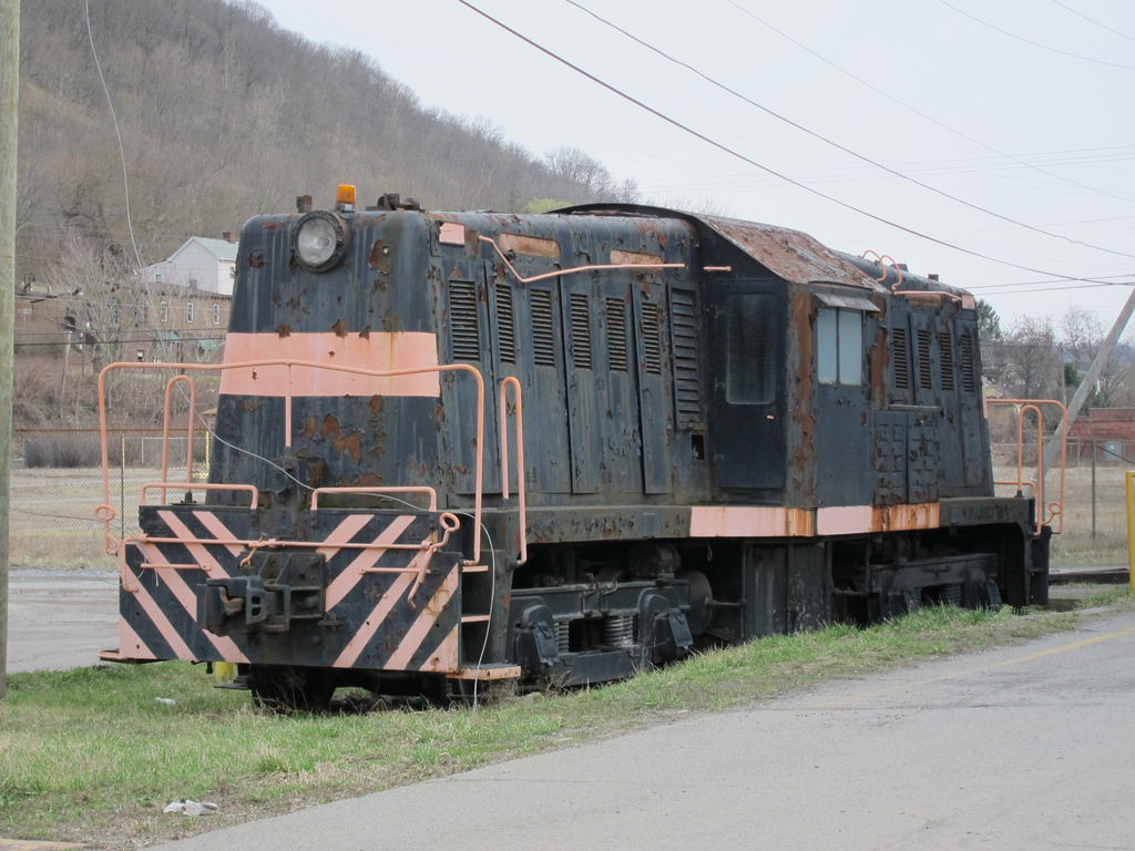

I'm currently trying to find some info on Wheeling Steel #6505, a Whitcomb 65 tonner on the property of the Benwood Steel plant. I've since had some talks with the property manager about preserving the unit and it appears that may soon become a reality. However neither does the owner nor anyone in the company know any significant history about the unit as of this moment. If any RYPN member is informed on the topic it would be very appreciated. Thank you,
Cameron

About the only thing I can say is that it looks like a former military Whitcomb--but around here, that would be stating the obvious.

Update:You are correct on that point, it is indeed a former army unit built around 1942 for service on the Trans-Iranian Railway.According to the owner the #6505 was subsequently sold to Wheeling Pittsburgh steel sometime in the early fifties and retired in 1979. Its been on the property for some while after and has been started up in the distant past. I'll double check on that those dates the next time I here back.

It looks like Wheeling had six ex-Army Whitcombs. All were 65 tonners and none were built in 1942. Three were built in October 1943 and three in early 1944.

Incorrect. That was Wheeling Steel's road number, reflecting the loco's nominal weight of 65 tons. The various USATC series for locos of this type were the 7900s, 8100s, 8400s, and 8800s. The key bit of identity needed is the loco's Whitcomb serial, which would be in the 60000 series.

Here are the Wheeling Whitcombs built in 1944.
60364 1/1944 B-B Std 65DE19a 65 650hp
U S Army #8123
Wheeling Steel, Wheeling, W Va
60430 4/1944 B-B Std 65DE19a 65 650
U S Army #8424
USATC-Italy,Military Ry Service #1338
Wheeling Steel Co., Wheeling, W Va
60502 9/1944 B-B Std 65DE19a 65 650
U S Army #8496
Wheeling Steel, Benwood, W Va
They had three more army units built in late 1943 and one they bought new in 1949.
