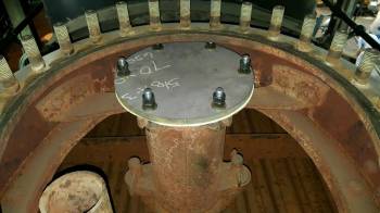

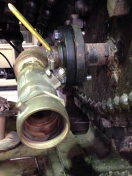

Work continued on final preparations for a preliminary hydro test. All but one of the last washout plug caps had lapping completed and caps were installed. There is one washout plug remaining on the bottom front of the boiler that requires some additional lapping to complete. We removed a high pressure steam plug from one of the relief valve ports to measure the plug for purchasing two more. The two remaining ports have adapters that will also likely need to be removed and have a hydro testing plug installed. Flange cover assemblies were fitted and made up for an air testing flange, water filling flange, and cover plate for the blowdown port. A dry pipe cover was installed to seal the boiler for the hydro test. The boiler check valves also need to be carefully inspected to see if they need lapping as well.

File comment: Hook up for filling boiler with water for hydro test.

File comment: Blanking plate fitted and bolted to dry pipe flange.
