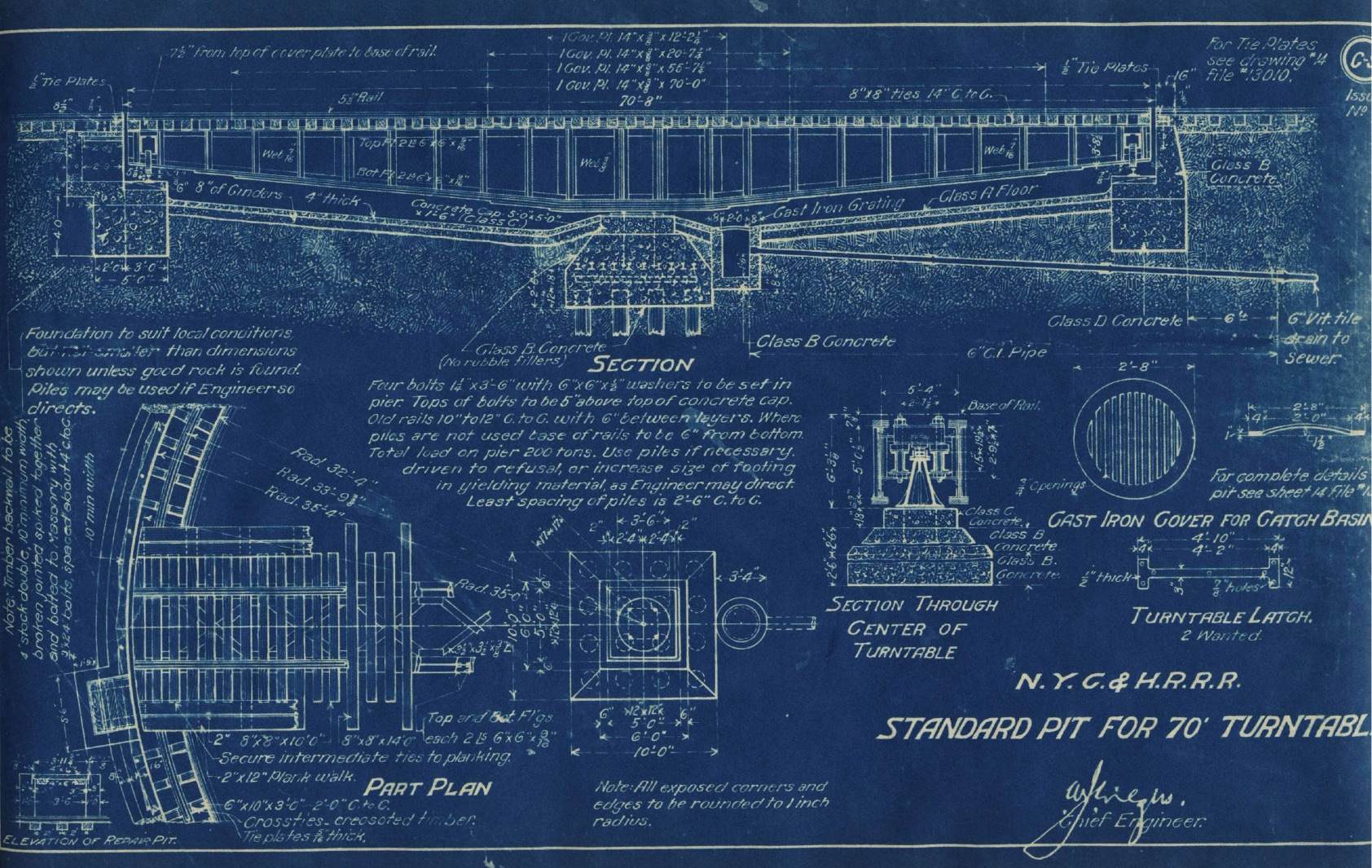

A little large, but you can read it....

That's nearly identical to the drawings in this thread:
viewtopic.php?f=1&t=39624

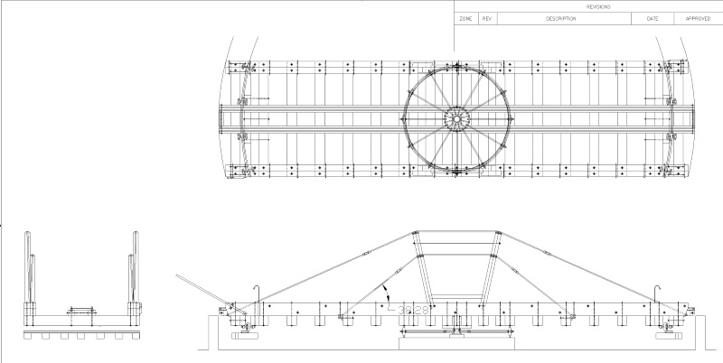

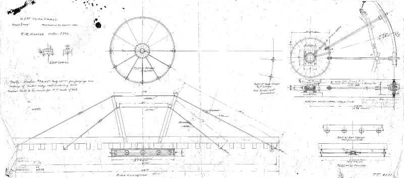

To add to the WW&F Turntable being installed in Alna, ME:
It's construction was funded, in part, by the Amherst Railway Society's Founder's Award - and we thank them for their generous donation.
The Portland Company designed the table, and we used the original drawings for our design, etc. We only made a few adjustments. The original WW&F had nearly identical turntables of this design in Wiscasset and Albion Maine. The replica is essentially the same.
It will feature a 48-foot wooden queens post turntable bridge. To our knowledge, there are no surviving examples of this design.
File comment: Revised (2014) design (Not for construction.) Contact the WW&F for a complete set of plans/drawings.
File comment: Original Portland Company Plans
