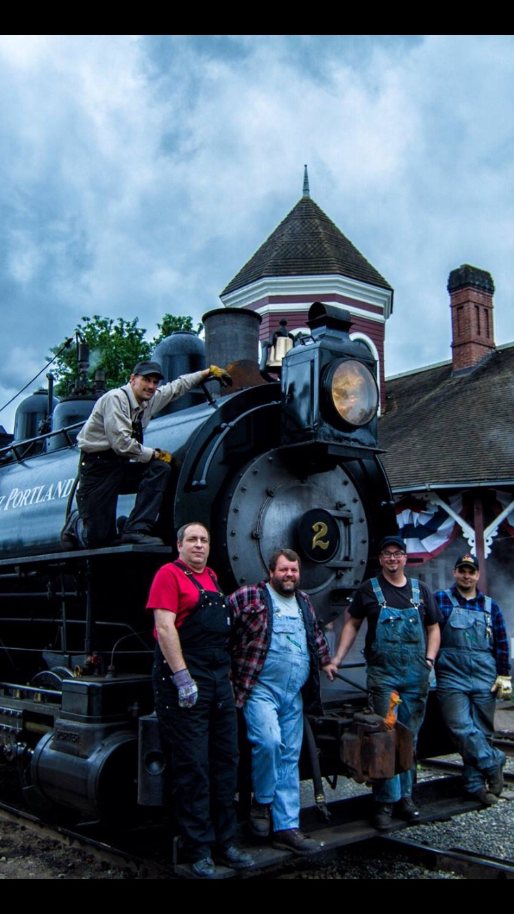

Congrats to Skip and his crew!!!! These are exciting times!!!!
And Lee, steam is alive and well at the Northwest Railway Museum, come by any weekend between now and mid September and say hi!!!!
Best,
Stathi
Best,
Stathi
