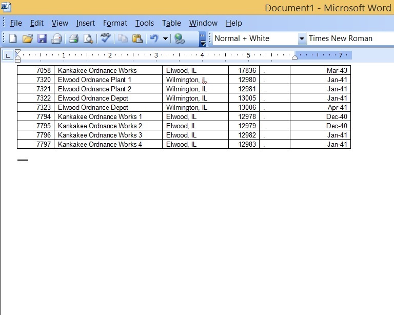

Hello all, I am a newbie to this site. I am not a 'train guy' but I am doing research for the former Joliet Army Ammunition Plant(JAAP),built in 1941 and since decommissioned, that was located near Wilmington, Il. It was actually 2 separate facilities that were merged into one: Kankakee Ordnance Works(KOW) and Elwood Ordnance Plant (EOP).
I found a listing of some or all(I'm not sure if there were more)of the locomotives( I apologize if I am using the wrong terminology)from the DieselShop website. Is there any way of obtaining more information as far as the builder, photos, disposition, etc? I see there is a book (2 volumes?) titled: "United States Army Transportation Corps Locomotives" that seems like it would provide the info I'm looking for. Unfortunately, I cannot find a copy anywhere close to me (Chicago). Can anyone help?
This is for a research project on the heritage of the former arsenal, as well as pre-war residents. Any help would be greatly appreciated.
Thank You.
Thomas

Since you didn't give the builder of the locomotive this took a little while.
General Electric
12978 45T D/E B-B Std 33” 300hp Cum HBI-600 (2) 12/24/1940 B-B-90/90-2GE733
Stone & Webster Engineer Corp –contractor for- Center cab
US Army #7794, Kankakee Ordnance Works #1, Elwood, Ill
US Navy, Naval Ordnance Plant, Louisville, Ky
USN number series initiated 1949-1950-Numbered to #65-00497
Kentucky Ry Museum, Louisville, Ky 5/1972
12979 45T D/E B-B Std 33” 300hp Cum HBI-600 (2) 12/26/1940 B-B-90/90-2GE733
