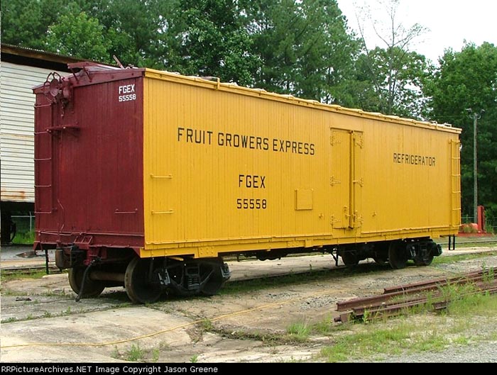

Does anyone know where I could find color codes for a Fruit Growers Express wood reefer? I'd like to replicate the simplified, and slightly darker shade used after the 1940s. I found this example at the Southeastern Railway Museum, they recently repainted their FGE car.
File comment: FGEX 55558 at Southeastern Railway Museum, Duluth, Ga.

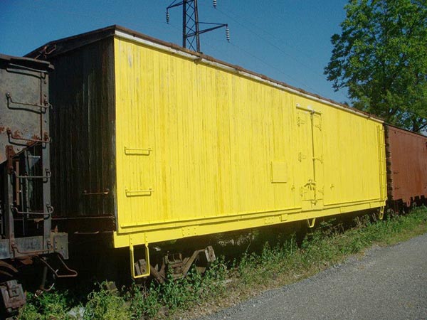

Last year, a gang of volunteers applied primer and yellow paint to the east side of our FGEX 50220. The color is a little too bright ("English Daisy") and since we're getting ready to do some work to the other side of the car, I figured lets get the color closer.

Does anyone have information on FGE red and yellow colors?

Shamelessly plagiarized from the instructions for Martin Loftin's beautiful and accurate FGEX 40' reefer (Sunshine Models, Box 4997, Springfield, MO 65808-4997):
Paint schemes applied to FGEX cars in the late steam era had yellow sides; red ends, kick board and roof; and black underframe, side sill, trucks, hinges, ladders and grabs. In the late forties or early fifties, grabs, ladders and latches became the color of the underlying carbody--yellow on the sides and red on the ends. The sidesills were briefly red. I believe the cars eventually became yelow on the sidesills, ends and end details also. The yellow was a reefer yellow when new, but in the late steam era, this didn't last long. Sunshine recommends a Santa Fe Warbonnet Yellow or a mixture of 10 parts yellow, one part orange and a "touch" of brown. If you model ten cars and they are ten different yellows, that would not be unprototypical!

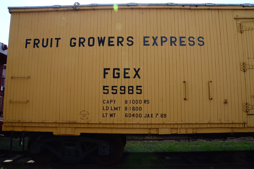

We have FGE car number 559-- at Midwest Railway Preservation Society in Cleveland. One side of the car has been repainted and we are in the process of doing the other side right now. One thing that may help you out in your restoration is that we replaced all of the stenciled information that was on the car including the built date, light weight, loaded weight, cubic foot capacity and much more. i will try to post some photos when i get a chance. Our car is the darker yellow color similar to Southeastern Railway's car. Here is a link to our Facebook page which shows the car during our night photo shoot from last year. https://scontent-atl3-1.xx.fbcdn.net/v/ ... e=57E3E23A

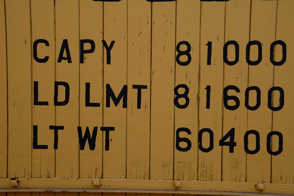

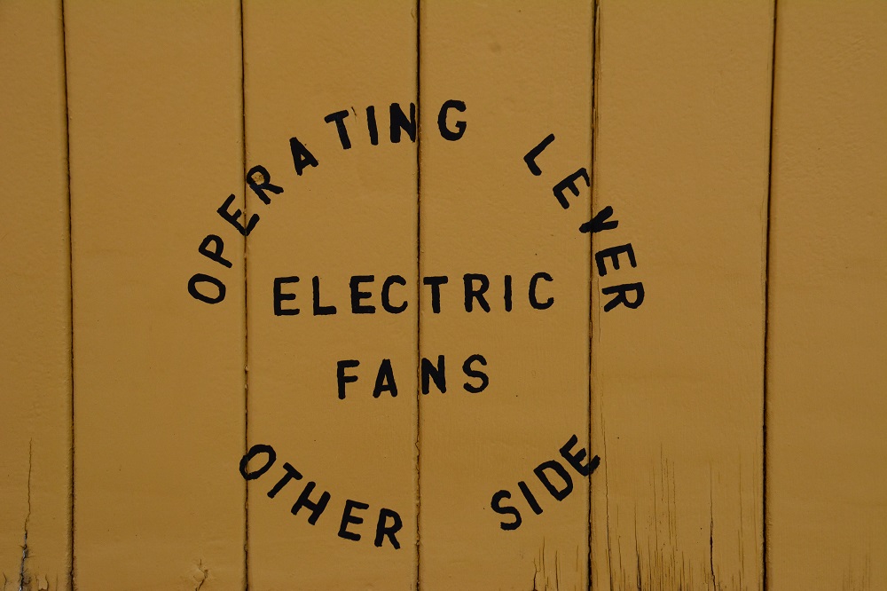

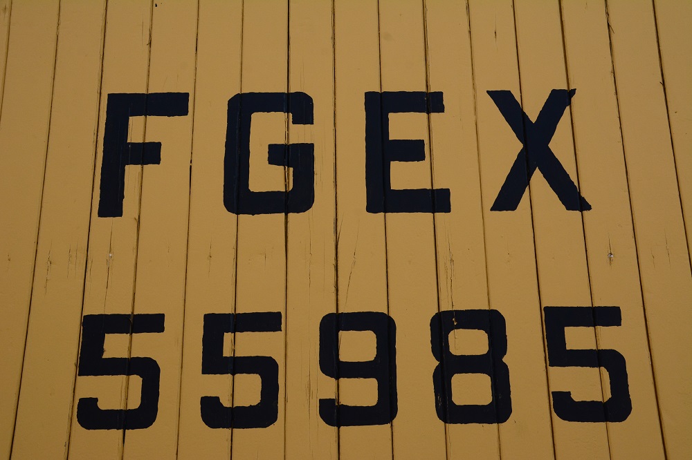

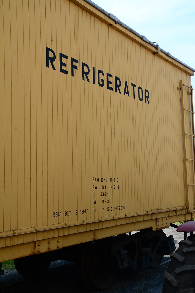

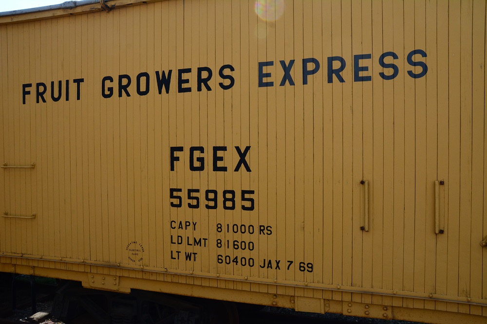

These are some pictures of the FGE car at Midwest Railway Preservation Society in Cleveland, Ohio. We hope this aides other people in restoring similar cars.

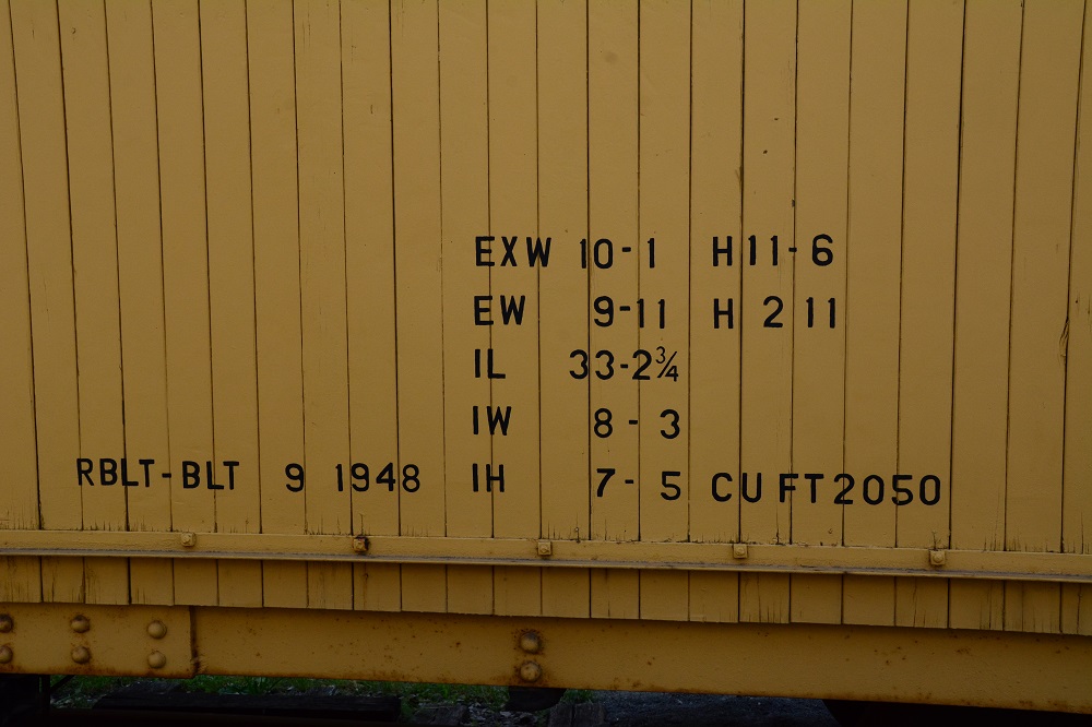

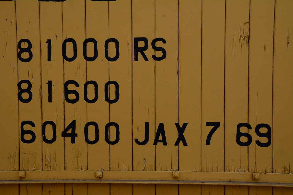

This is not original paint, it was repainted some time recently. We did make an effort to duplicate the lettering on it and I am posting the photos of that so the other groups that have cars can do that also if they want to. This lettering was done by a sign painter who used a small brush along with a stencil pattern. The tongue and groove wood siding makes it impossible to just use a stencil and spray can because each groove will have paint running down into it.
In photo number 7 I am not sure what the difference is between EX W 10-1 and EW 9-11 and also H 11-1 and H 211. I think that H 211 may be a mistake and it might be H 12-1.Where EX W 10-1 would be external width 10 feet 1 inch, what is EW 9-11? And why the two H numbers? The other length, height and width numbers are easily understood.
I thought I just answered this a couple months ago in a different discussion, but here it is again. EXW is the EXTREME WIDTH, and the H on the same line is the HEIGHT above the rail to where the extreme width is located; in this case it appears to be at the top of the door, likely the top door locking bracket. EW is the EXTERIOR WIDTH, measured at the eaves, and the H on that like is the HEIGHT to the eaves... the stenciling is missing a 1, it should be 12-11. The three lower lines are the interior dimensions; the IL is so short because it is between the ice bunkers.
