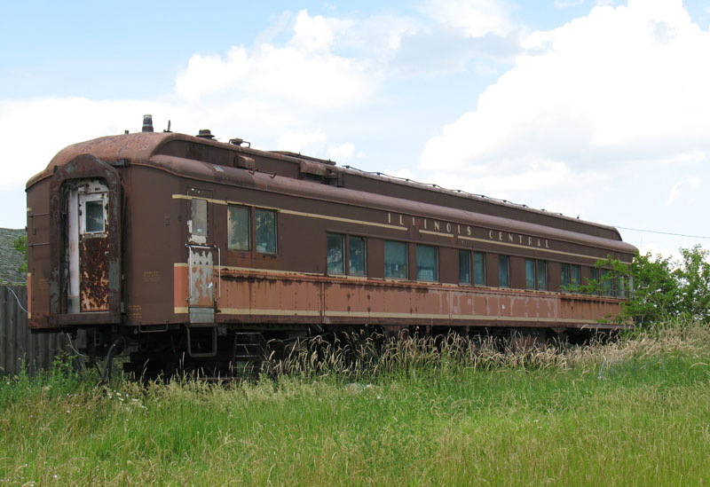

No longer extant but IC Business Car 2 survived at least until 2008. This is the car that was located at the Thompson Winery south of Monee, IL for many years (with the T&NO 4-6-0 and two ATSF head end cars). It was later moved to another Thompson property a few miles away. They were unable to sell it or even give it away. It was scrapped on site per someone who said he worked for Thompson.
