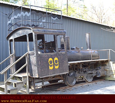

Here is a photo of the locomotive at Knoebels. I have some other photos of it somewhere, I'll have to look around for them.

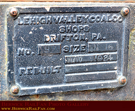

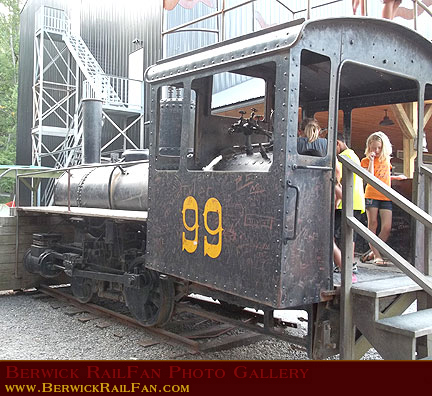

Quicker than I thought, I was able to find the photos the first time.

 Post subject: Re: Carroll Park & Western #117 sister?
PostPosted: Wed Jun 17, 2015 4:11 pm
Posts: 783
What in the heck is that abomination on top of the cab?

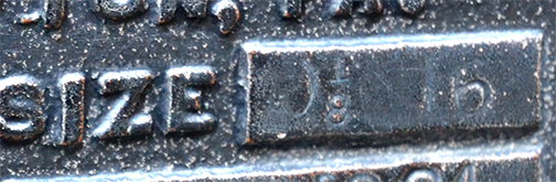

Dear Andrew:
Did happen to jot down the numerals adjacent to "SIZE" stamped on the builder's plate or do you have a photo in which it shows up a bit better? It looks like the stroke is 16, hard to tell the diameter...

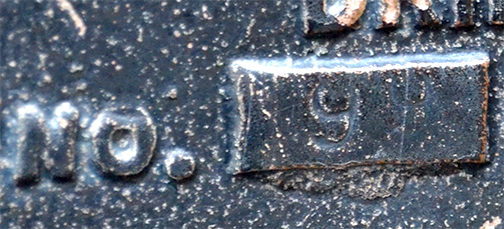

Posts: 70
These are the best I can get from the photos I have. We will be taking the kids there sometime in the next few weeks, I'll try to remember to get better photos. Only live about 1/2 hour away.
PostPosted: Thu Jun 18, 2015 2:12 pm
Joined: Thu Mar 06, 2014 3:40 pm
Posts: 70
Their attempt at adding a railing to keep the kids form falling off the top as they can climb all over the thing.

Posts: 618
Hi Andrew:
Thanks, that would be appreciated.
From the close up, it LOOKS like the "SIZE" is 9-1/8 and 16.
My guess is that the "SIZE" is the bore and stroke of the cylinders, but I could be wrong.
In any event, 16" stroke would be consistent with other small locomotives, however a bore diameter measured to 1/8th" would be unusual for a major builder (but the LV shops were hardly that).
My records indicate that No.99 was built using a new boiler purchased from Baldwin Locomotive Works.
I have no idea where the running and driving gear came from, but guess that another LV locomotive (or locomotives) was a donor of major components such as cylinders.
Thank you for your help.
J.David
PostPosted: Fri Jun 19, 2015 9:50 am
My guess is they bored out an out of round 9X16 cylinder set and recycled it. Poor little thing.......
