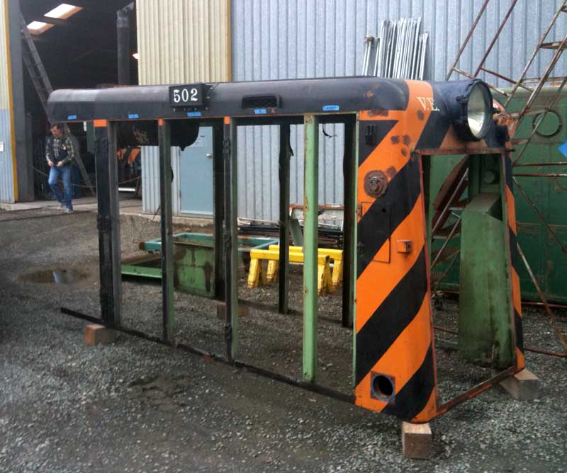

We do not want to remove the entire hood if we do not have to, it was cut once in the past and welded back in but I really do not want to get into that as we just repainted the loco.
The entire long hood is designed to easily unbolt. There are bolts along the bottom flange of the hood, and the firewall. (the stack fascia and radiator louvers come off first). Water lines need to unbolt, and all the electrical comes down to a single terminal block on the firewall.

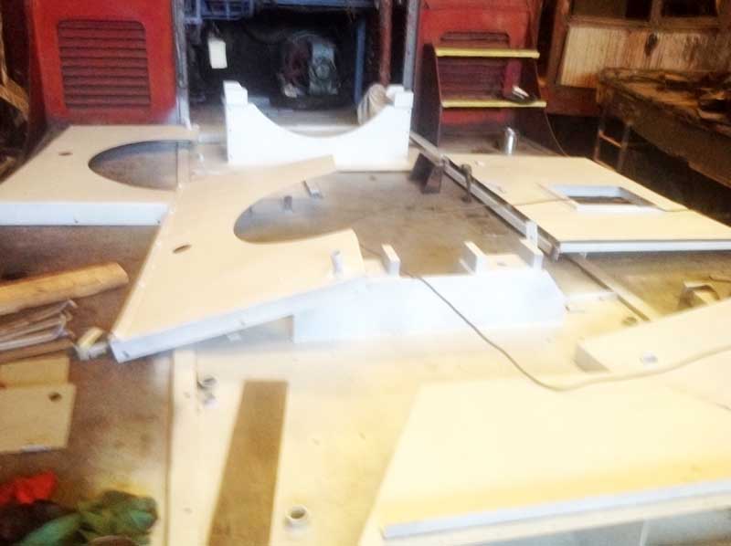

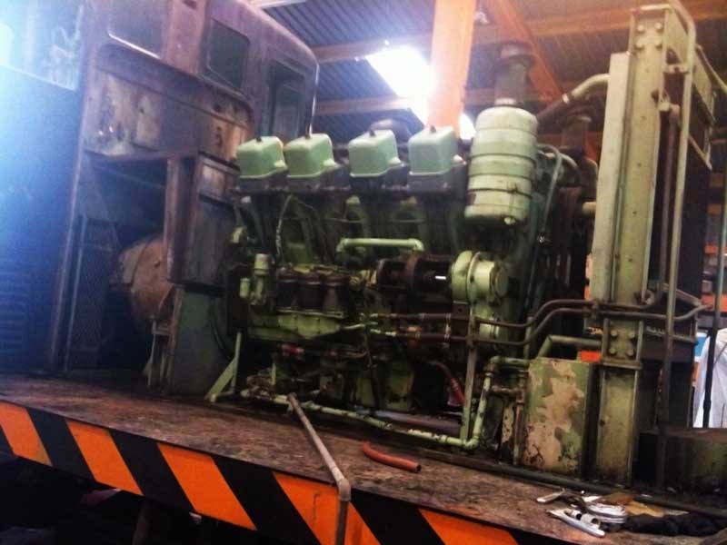

This is Visalia Electric 502. The hood was not repainted. The unit spent some months with the one engine being overhauled, and the unit was used with a single engine.

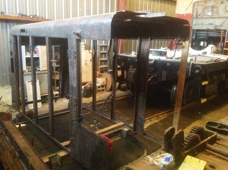

Same, with Sacramento Northern 146.
The lower picture really is of the engine bay. It's been picked clean for overhaul.
