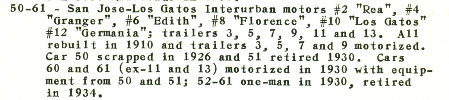

I just pulled my copy of The Western Railroader booklet 348-E about the Peninsular Railway Co. In one binding it contains three separate issues, 348, 352 and 355. The third one contains a roster.
Cars 50-59 are listed as being built in 1903 by American Car Co. American was the Brill affiliate located in St. Louis, Missouri. Additionally trailers 60 and 61 were also built by American in 1903. The next page of the booklet has this information:
The SAn Josse-Los Gatos interurban line opened in 1903.
The later book about San Jose Railway, Tracks, Tires & Wires: Public Transportation in California's Santa Clara Valley , Interurbans, 1981, may also cover the Peninsular besides the city operation. I should have a copy of that, but I've not gone after my copy.
I am sure the Museum's archives must have these and perhaps other information.
The width of the car body by itself does no necessarily indicate what the original gauge might have been. Some interurban cars were built to standard railroad passenger size and others were built narrower to better get through city streets. By example compare a British Columbia Electric interurban car to a Pacific Electric 1000-class.
