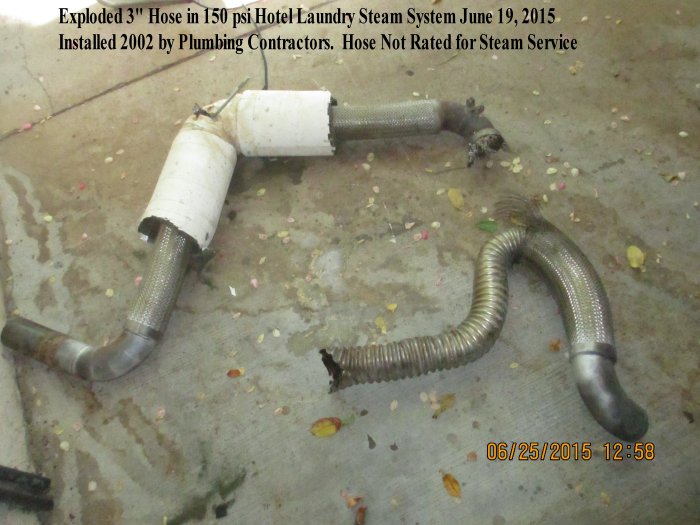

There are many different styles of SS braided hoses. One should always READ the specifications.

The picture of the burst steam pipe from hotel laundry is scary. The people working in laundry would not know what hit them if they were near by.

The hose only failed after 13 years in service. If you put a hose in service like that, it would seem prudent to replace it periodically. You can't leave it in there forever...it will fail sooner or later, no matter what the rating is.

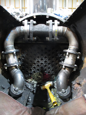

This is what the Puffing Billy did when using the flexible piece. I suspect they would change it at some standardized interval. Notice it is not the entire piece, but just a small part.

Stuart Harrod
Steam shop machinist
Nordsjællands Veterantog
Veterantoget.dk

Regarding the exploded hose, only by luck were there no dead bodies.
