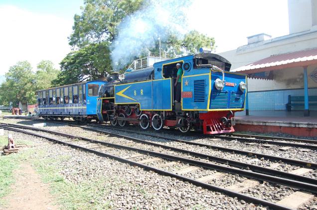

I thought this photo would be of interest. In India they built/overhauled four rack locomotives and converted them to oil. However, note they installed a diesel generator for what I guess is power for the oil burner. Also note the electric cab ventilation fan.
It is a frustrating choice for many of us that we wish they had the knowledge to avoid. However, I do know that the L&N General had a diesel (gasoline?) generator in the tender for powering the oil burner.

I really do not see anything wrong with the concept. There have been electrically powered auxiliaries on steam locomotives since the development of the light bulb. Lights, telephones and radios all require electricity no matter what fuel is being burned in the firebox. Traditionally this has been done with a small steam-driven generator and a battery bank. The weakness of this system is that you need steam pressure to run the generator. This means that if the batteries are down, you have to fire up the boiler to run any of the auxiliaries.
The General was built before electrical auxiliaries were at all practical and therefore was built without any. It the had not been designed to accommodate a steam-driven generator. The generator hidden in the tender was because the late and not in the least lamented Interstate Commerce Commission required an electric headlight. Had the L&N mounted a steam driven generator and obvious electrical auxiliaries I am certain somebody here would have complained that it was not authentic.
The Indian engines were rebuilt for regular service, not as an historical preservation project. A genset which runs on the same fuel and does not require steam pressure strikes me as a reasonable engineering decision.

One thing that has prospective merit is the provision of 50/60Hz AC to run locomotive systems and auxiliaries (using OTS motors, pumps, and other equipment designed for 'grid' electricity). This also inherently permits 'native' HEP, full power for PTC implementation, and better instrumentation and control systems.
This gives a choice of using steam or a diesel genset as the source of the auxiliary power -- or either a portable generator or 'shore power' when the engine is being serviced, fired up, or stopped for an extended time. Water rate can be reduced dramatically, and some aspects of boiler circulation much improved, once you have reliable power and data 'buses' available on a locomotive; there are also some advantages in reducing the number of lube, steam/tracer, and exhaust lines required to implement small steam 'motors' or other more traditional equipment.
While cross-compound pumps are an important part of the 'sound' of American steam railroading, and are reasonably efficient (I understand they can be more efficient, in terms of steam mass flow required for a given air mass raised to service pressure, than even an efficient 'electric' or shaft-driven alternative) I do have to wonder if an OTS equivalent, even if provided only as a backup, is not a reasonable idea.
With respect to the firing system: the technique used in the Golden Rock locomotives I've seen is similar to the approach that was reported for the 'converted' Reading 2100 -- mechanical atomization and relatively high-pressure primary and secondary air. That's a lot of work for the wrong heat-release pattern in the combustion plume and downright ghastly turndown behavior. Having said that, I do think that it's possible to implement a multiple-burner mechanical system, and powering the various pieces of it electrically makes increasing sense, if you need high heat release from light oil (#2 diesel) firing.
Note that most of this doesn't come under the heading of 'historic preservation' at all. Whether or not working steam would have come to utilize some of these technologies is an open question; if I remember correctly, Porta had it 'both ways' depending on the sophistication and general creditworthiness of the country supporting a given locomotive. Here we are looking more at the market that was supposed to be characteristic of locomotive 8055, 'plandampf', the SLM/DLM rack locomotives, and much prospective excursion service for 'new build' steam (specifically, the 5AT and Turbomotive 2) and anyone interested in 'pure' historic preservation can stop reading at this point.
