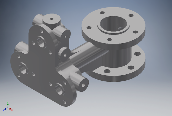

The turret in particular is a cast iron turret built to a Henschel standard design from 1907. It has no ability to shut off the steam supply from the boiler flange, and is built so the safety valves are connected to the boiler through the same boiler connection as the turret. We are currently sending it away to a company to do NDE dye testing and then pressure testing with water.
I am mostly looking for info on the use of old cast iron turrets being illegal, due to their age or construction. If not illegal, than any considerations we should take into account when using it!
It is indeed an old turret on an old boiler
File comment: a cad rendering of the turret I made when looking at a welded assembly option

I would have your turret subjected to material analysis to see if it is really cast iron or if it really is cast steel. Often we confuse the two. It was not uncommon for these items to be cast steel....but called "cast iron."
We have made turrets like this as fabrications. In fact, we have made super heater headers, turrets, pipe flanges and all sorts of things that once were "cast" items, but that are now more economical to fabricate. The drawing shown would not be a difficult weldment to produce. It is a few flanges, some pipe and a few other shapes, all of which can be designed using Sections I/IX of the ASME code and using materials found in Section II.
Consider reverse engineering the turret. Paul mentions in short and I am trying to emphasize; it really is up to the jurisdiction if they want to accept it or turn it down. I can give you 5 examples in the US where they are accepted and rejected (which is why we have fabricated these items). You could have a UT study done and determine by methods of reverse engineering if the turret is still "sound" however, I would check with your jurisdiction to see if they will accept the results if shown to be favorable. No use spending money to reverse engineer if in the end the jurisdiction says..."Cast Iron...NO WAY...." Jurisdiction could say things like...."we will accept if it makes a margin of safety of 6." Or, "We will allow two more annual inspections with the item and it needs to be replaced." Or, "We simply are not allowing such items to remain in service."

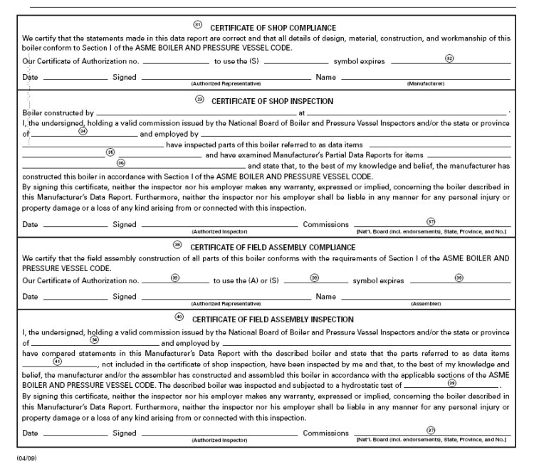

Paul Boschan wrote:
Any component in the system that falls within the boundary must be manufactured and assembled by an ASME Certificate holder including mechanically assembled piping. For a locomotive boiler the boundary, called "Code jurisdictional limits" in the text, is the boiler itself and any piping or appurtenance attached to the boiler up to and including the first valve.
There are 2 boundaries defined by ASME Section I Power Boilers. The first is the "boiler proper" which is the pressure boundary up to the first nozzle. This is certified by the Certification of Shop Compliance and Inspection on the ASME P-2 Form. Plug the blow downs, feed water nozzles, safety valve holes, washouts, etc, blank the dry pipe hole and conduct the 1.5 MAWP hydro and sign off the boiler itself.
All the Boiler External Piping, from the boiler nozzles to the limits of the BEP are supposed to be certified by an ASME "S" or "A" Stamp holder and documented by executing the Certification of Field Assembly and Inspection portion of the ASME P-2 form.
I have never seen a Field Assembly executed on a locomotive P-2 form. Some Jurisdictions do not enforce this for small boilers (less than 200 BHP). From a practical stand point, even if the piping is threaded together by a pipefitter, what extra safety is accomplished by mobilizing an "A" Stamp holder with Authorized Inspector to witness a hydro and sign a form at a cost of $3K+? Especially if the boiler is the size of a 55 gallon drum, has no tubes, costs only $8K and feeds a dry cleaner...
Most AIs that never inspected a locomotive boiler before probably never saw a steam injector either. Your Chief Inspector may vary.
