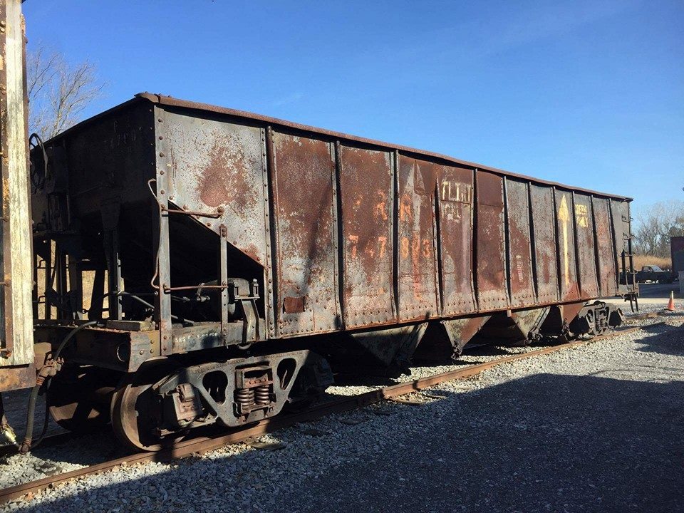

We had the freight cars moved to Track 9 on April 16.
File comment: MDT 12549 - April 16, 2016
File comment: PRR 747803 - April 16, 2016

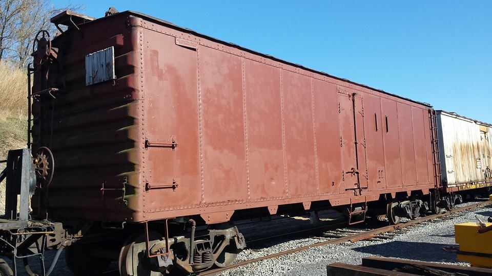

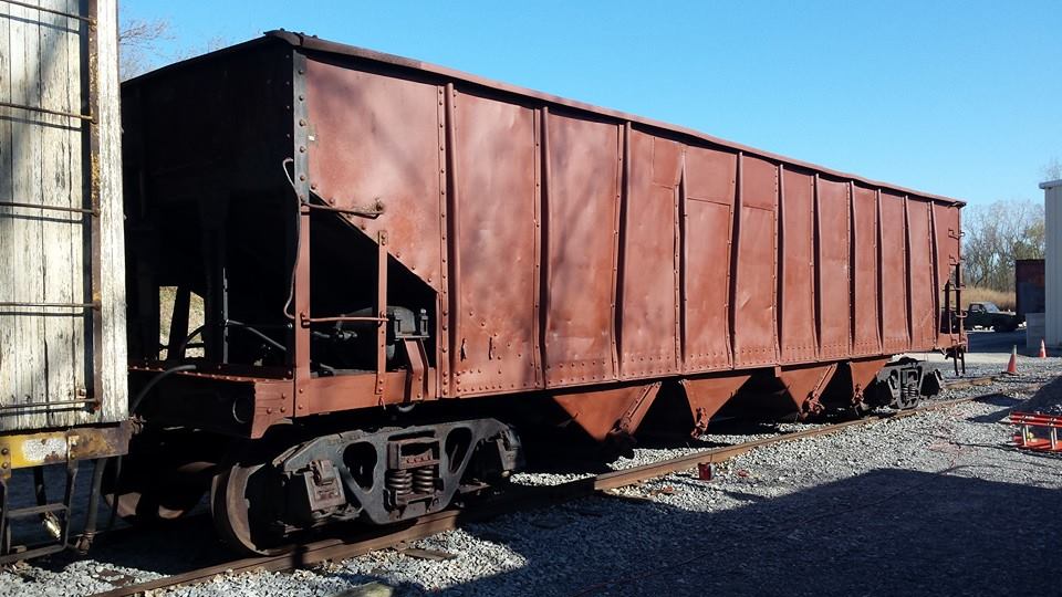

We scraped off loose material the following week, and had a coat of Rustoleum Rusty Metal Primer applied by April 23. It took less than two gallons per car, per side.

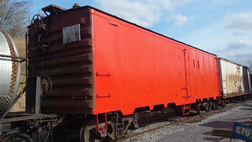

By April 30 we had applied the first coat of paint to the west side of both cars. A note on the reddish-orange color on the reefer, I thought I was being smart by mixing two gallons of yellow with one gallon of red to make orange (sort of).
File comment: MDT 12549 - April 30, 2016
File comment: PRR 747803 - April 30, 2016
Turns out the Rustoleum red pigments are stronger than I had estimated. I'm thinking my new formula for the next coat will be two gallons yellow to one quart red.

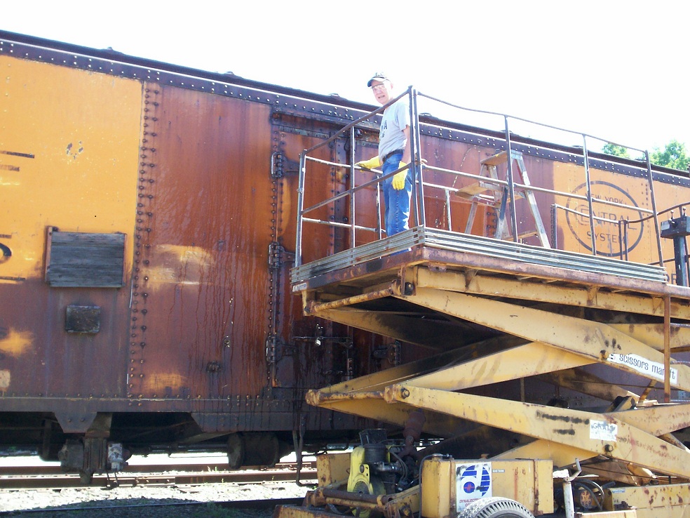

Nice work! We have two MDT ice bunker steel refrigerator cars at Hoosier Valley and fortunately, have been able to just clean them to make them presentable. The first photo shows yours truly working on MDT #13385 about 10 years ago, and the second shot shows the cars appearance just last year. Some day we may have to do a complete repaint, but up to this time, that hasn't been necessary.
It's nice to find other cars that Merchants Despatch Transportation has donated. Their past generosity is heartwarming. Perhaps one day we could get a list of the cars that MDT has donated through the years. Our two cars were actually located in the old Pennsylvania Railroad yard on the south side of Chicago and were being used for old paperwork storage. When these old papers were no longer deemed necessary, the refers became available and HVRM moved them to the museum in North Judson.

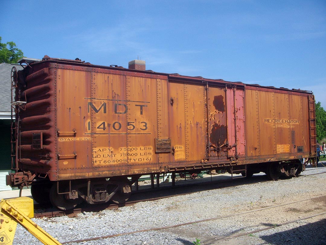

MDT 14053 is in much better shape, and houses a display about DSI. IT was built by PCF in Renton, Wash., in 1958 for NRC, and was later transferred to MDT in 1962. It was used as a support car in Enola, Pa., as Kevin explained above. Moved by rail in the days when you could still do that without anyone blinking an eye.

Otto - if MDT 13385 above is the right color, you might be better off using yellow with a little bit of chocolate brown in it. In any case, to match the color, this is what I would do (since I was a color matcher in the printing industry for a while).
1. Buy a glass measuring cup with a handle.
2. Open a can of your yellow paint, and paint a little on the car so you have a starting point.
3. Pour that gallon of yellow into a bigger pail. Then get a quarter of a cup of chocolate brown, pour it into the yellow and mix it up. Then paint a little on the car next to your yellow patch and see what it looks like. (Starting with a very small amount of the darker color is recommended, because if you overshoot, you can't take it out again).
3. If the yellow is still too bright, slowly add more brown and record how much you add. Paint another small patch on the car each time.
4. If the color looks like it needs red, add it in small amounts, record how much you add, and paint a small patch each time.
This will not only give you your desired color, but also a formula which you can use to mix it again. However, I would mix enough at one time to do the whole car, because minor variations in mixing several batches could yield slightly different colors.

Nah, four years of art school to be a graphic designer, I gotta do something with the degree. I just mixed a new batch using two gallons yellow, one qt. red, one qt. yellow and got a color much closer to what I wanted. Behold:
File comment: Revised orange from May 7, 2016
I had just enough paint to do both sides. The ends are in pretty good shape, so we won't touch them for now.
